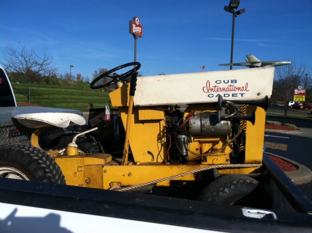

Thanks to all. im thinking the ramp ends and some lumber. my old 4 wheeler ramps were very heavy duty aluminum compared to the lightweight ramps that are afordable. they were 6ft ones and made a steep incline into my bed driving the 4 wheeler up. im thinking 8ft boards to make it a little easier. i have plenty of tie downs laying around, no-come-along though. the O is a roller so it shouldnt be too bad. for $50 i will be getting it in my truck somehow.

Now thats the way to load a roller into a truck!!!
