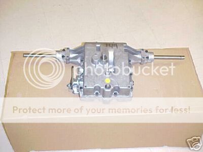

Story first then I'll get to the nuts and bolts of my issue in the next paragraph. I need a riding mower and I'm too cheap to buy a new one. After weeks of looking I found a steal of a deal for $350 for this mower with a bagger. I drove to pick it up, it started great, ran great, I test drove it and it ran and mowed fine!! So I paid the guy and began loading it in the truck. As I drove it down the first hill to load it I lost the brakes and almost hit my truck, easy fix. First mow I had 2 belts break, but were old and cheap. Then after the first mow I lost high gear and really lost everything but reverse is strong. Now the questions...
I took the transmission to a Peerless DEALER and they couldn't find out the model and/or fix it for me. They didn't charge and gave me a box of parts back. I need the shifter forks, and the drive gear ($90 if the dealer knew which ones to get) So now I turn to the Cadet Pros.
Do I buy a whole new transmission? Is there a cheap alternative? This may not even be the original???
Can anyone identify this one so I can buy parts?
Is this worth the fix or should I cut my loss, engine is strong and mower and deck have no rust at all!

There are two possible choices for the trans in that tractor. Go to cubcadet's main web page, or partstree.com to look up the parts. The diagram tells you where to find the tag to identify your trans. Not many of the internal parts are available anymore. You would probably be money ahead to find a used one. Check with our sponsors at the top of the page, or place an ad in the "wanted" section. Personally, I don't consider these trans-axles worth rebuilding. Good luck!

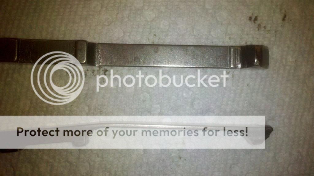

Here are the parts the dealer said I should have replaced, I washed them for good picture quality. When they were looking to order these for the 1315 model, the gear sizes were way off and the shifter forks were way too long. Basically, for someone who understands transmissions, Are these 3 parts a reason for reverse working fine, but 2nd gear on being choppy and skipping.
