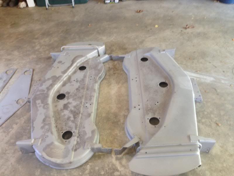

Back from sandblasting. The yellow one had some deep rust! Pretty pitted. I have a primer with a hardener in it. Gonna use that. Most of the little parts are media blasted or wire wheeled and ready for paint. Need to get seals and 2 new idler springs. Know of a good place to get seals?

The best one has a pretty nasty weld on the rear wheel bracket ( bottom on right) and a couple of cracks. The belt cover has a hole in! Got some grinding and welding to do before I can paint...

Seals are expensive and I did a lot of research to get them. I got Chicago rawhide seals from ksc direct.com. Cheapest price I could find but still pricey. That is to say that your deck uses the same spindles as my 42 inch does but it looks like it

found them at Mowtownusa thru Amazon for 1.99 each plus 9.00 shipping!

Must be different part numbers then. What's the part number that you're getting?

i used eastwood rust encapsulator on my 38" deck, so far so good

Cub cadet part # 921-3018a Just do a search on Amazon.

Finally! Got to work on the decks this weekend one set of spindles back together, And everything primed. Hopefully paint and reassemble one this week. I need to mow. Have to rob a spindle off the 44c ( which wont keep a belt on )I'm currently(not)using to get them both back together! Then I can repaint the QA36 thrower I disassembled and had sandblasted With the mowers. At this rate I'll be done by spring...
