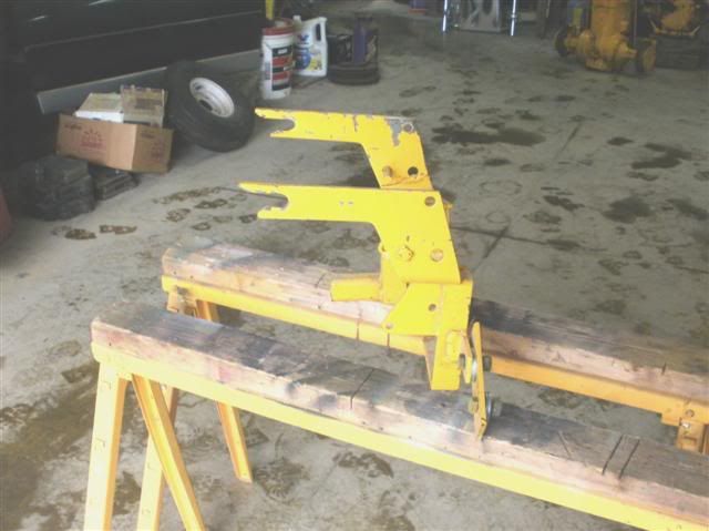

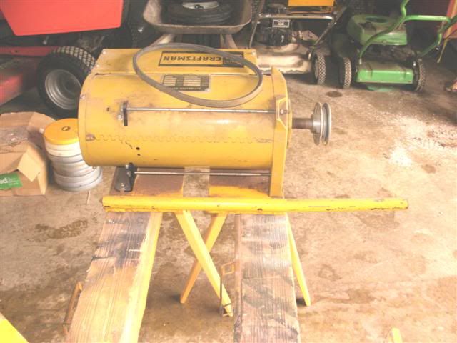

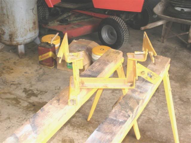

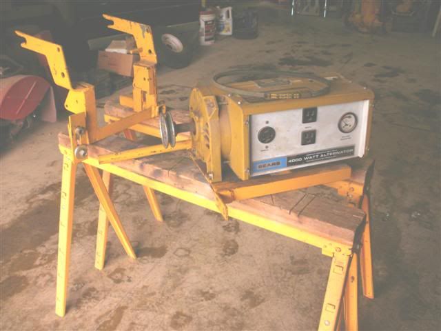

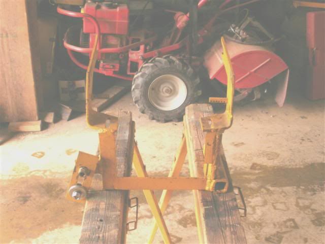

Here are few closer pictures of my generator set up. There are 2 parts to my set up.One part connects to the tractor:
This part has to be connected to tractor first.
Generator part:
Both parts together:
The belt tension is set by allowing gravity to do its thing and tighten bracket between both parts.
