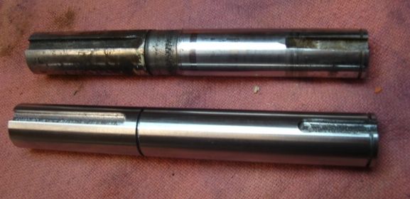

Jeff, I took the gear box apart today and I definitely need a new shaft. The short one is in good shape with no play but the long one is toasted and will need replacing. I am going to take the whole tiller apart and repaint it. So I'm not going to be using it this season, but I would like to be your first customer on a new long shaft for the bottom pully if your going to make some.
Attachment 50788
Version 2 with both snap rings grooves
It's just like the original only a "little" different ( no burnishing by a worn bearing )

Hey Jeff, I'm not 100% sure at this moment.... but I think there is a snap ring groove at the top of the long keyway to hold the bottom bearing on. I have a box apart at the shop I can check.....
Not trying to point out problems, just hate for you to ship it if there is supposed to be one.

I made another to send to him and corrected my print.
