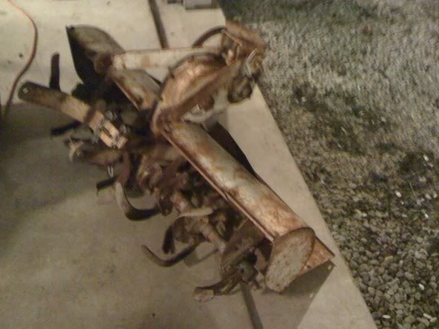

Well I picked it up last night and I was in heaven. The guy had a ton of cubs there, he said there was about 140 there. Had a nice 100 for sale I was thinking about getting.

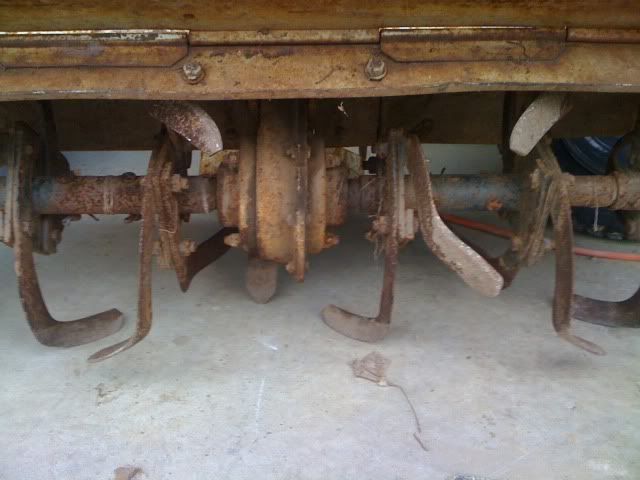

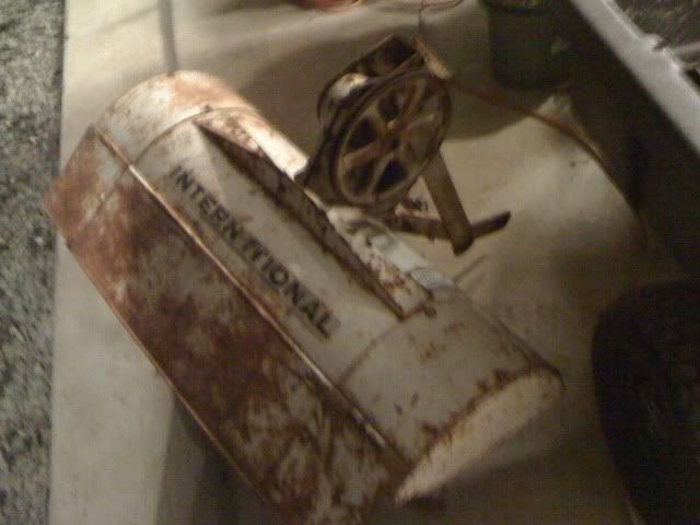

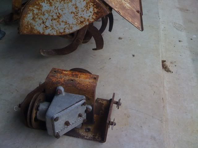

So here is the tiller, a #1 with two extensions. I need to pick up two belts, and some bolts to bolt the gearbox to the rear from what I'm seeing so far. It's raining here so it might be a few days before I get to put it on.

I need to dig in the book again, I think it gives bolt sizes for the gearbox. I am sick today so I stayed home. It's driving me crazy not being able to go work on it. I am hoping to feel better so I can run out and try to find hy tran fluid and a filter so I can get that changed before I put the tiller on. Maybe try to pick up the bolts and belts while I am out.
The tiller book shows to weld a rod on the mule drive pully to adjust tension. Mine only had a pain in the but spring on it now so thats something else to look at. Still have my hands full.

Saturday I picked up both belts for the tiller based off the belt chart from Carquest. I know the big one was 144 7/8" or so. I still have to clear out the garage so I can have room to work on it.
Yesterday I was able to make it to a Case IH dealer, I picked up 2 gal of hytran, trans filter, air filter, and rear gasket. Just for the fun of it I decided to ask if they had the large belt for a 127 with a #1 tiller. He looked it up and said yes, it's 141" and $86.
Hopefully sometime this week I can clear my garage, change the fluid and filter, the guy at the dealership said I should pull the rear cover off completly to clean everything out. I have to pull off the dozer blade, make some type of bolt adjuster in place of my spring tension mule drive, and get the gear box bolted on to try out the 144" belt I have. If that doesn't work I'll have to take a trip out and get the 141" belt. Hopefully I can have it all together by this weekend to try it out on the garden.

I had a heck of a time finding a replacement belt for my 1A. As far as I know, the long belt, as with the gen/starter belt, is cub only because of the deep V design.
I had to go to my local cub dealer, and even then, it was special order.
As far as the bolts go, almost every bolt is a 3/8-16. The bolts used to hold the gearbox on are 1" long. When I take the box off, I double the washers up so the bolts don't bottom out.
That's good that the tiller you bought has the extensions and covers.
Before you use it, you'll want to slide the tines off, clean up the shaft, and grease them. The pins on mine were so worn, it took awhile. I found this out while using it, and getting it apart while it was covered in dirt, in the field was a nightmare.
