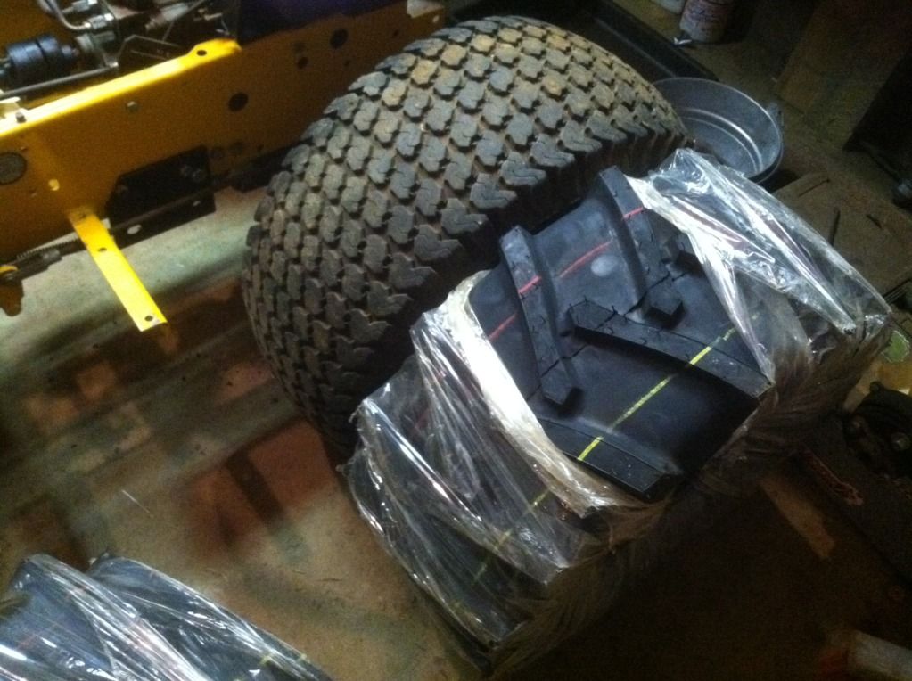

Got new boots today, they are going to look sweet on the 10.50 rims I also got V61s for the front
Old 04-17-2015, 07:28 AM
Posts: 18,911
Nice rubber buddy. What are they? Who did you get them from? What are you doing for wheels?
Thanks Sam, they are the Firestone flotations from Miller. I'm going to be running Xtreme 10 1/2" super rims.
