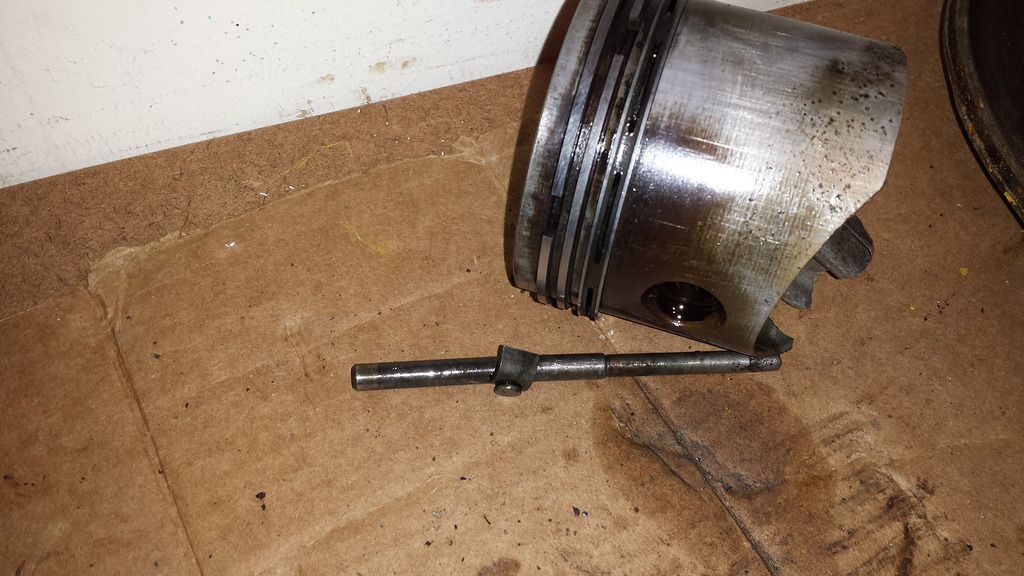

Originally Posted by timbo2 View Post
Total carnage-
looks like the governor bit it too, wonder if that happened first. There are small chunks broken off the bottom of the cylinder bore so I assume this is a goner.
This is what my Govner look like

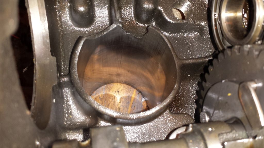

I'd say the rod sized on the crank and that started the problem.
Lets see some pictures of the block spigot, many times a chunk out of them causes no problem.
Clean up the crank,prolly .010 under, do what is necessary to the bore, check/do the valves and you are back in business, and you will have a "new engine" rather than some turpentine overhaul used one from evil pray or ??
----just my $.02.:Blah'b;Blah:
George - what is the 'block spigot'? should get more pics later.
thanks
- Tim

It may be rebuildable, it all depends on the block and crank.

sorry,
the part that is chipped out, the part that extends
into the crankcase.
Many times they take a hit ( chipped out) but the block can be reused.
Many an engine of various kinds is running just fine with a chipped spigot or extension of the cylinder bore if you prefer.
it depends on the severity of the damage.

ah I see what you mean. I was wondering that since the piston doesn't go down that far.
However I think I saw a crack extending up another inch or so. May get a pic soon. Too full from dinner!
thanks
when pullers build stroker engines that part gets ground off anyway so i doubt it will hurt.

OK- I was wrong there is no crack extending past the chipped parts. cross shaft tab broken off too. It must have over RPM'ed.
You don't know if it over-revved? Weren't you there?
The block may be salvageable. Get it magna-fluxed (crack checked).

On your connecting rod cap- Was the oil hole towards the cam or away from the cam before it blew?? I've seen this a few times and it ends up looking like what you have. If it was away from the cam, it won't get enough oil to stay lubricated, especially at higher RPMs.
