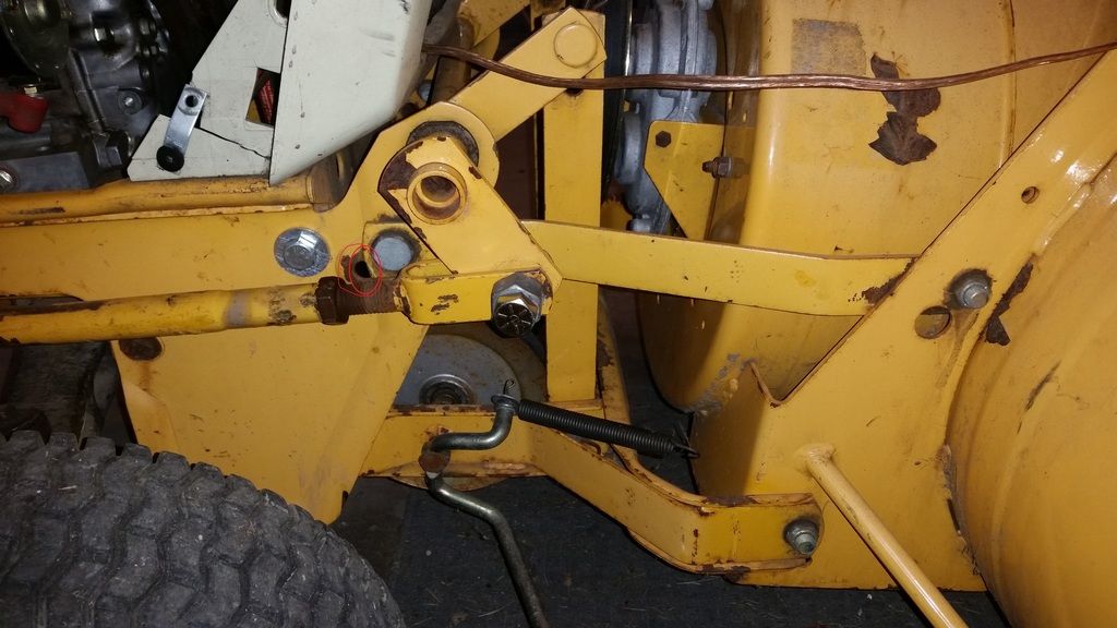

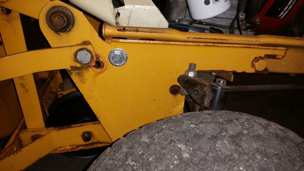

Here are the photos that show that the blower frame is bolted to the tractor frame. I did notice that there is another hole down (Circled in RED) a bit and back a bit. I am wondering if some one didn't put this unit together all that well.
I also pulled on it the direction that it has been twisting and I couldn't make it do it. Tonight I think I'll take it out and just set it on the drive way and see if I can make it do like I would be using it to blow.

Maybe this is nothing but I have wondering, if you are looking at the blower in this pic; the top is pitched forward. When I set it down it levels out. Is that normal, or is this do to ware?

I can't say for sure but I think that upper link belongs in the hole you have circled in red. At least that's what it looks like on the Cub parts site. I'm wondering if the PO drilled an extra set of holes because the drawing only shows the hole you have circled in red.

I moved both arms back to the hole I have circled in red. The whole blower does look better as far as it being more square as it comes up and down.
