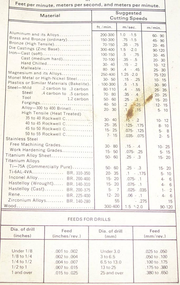

Slowest speed? Thought metal wanted speed?
There is a thing called "surface footage". You need to match the cutting tool diameter with the material you are cutting to figure out the correct rpm.
Instead of the formula I use at work, here's a chart of surface footage for materials
Match the surface footage to the drill diameter
http://img.photobucket.com/albums/v7...9.jpg~original

A good quality 3/8 drill (ordinary, not a high production grade/design) in a machine shop in a rigid setup will run at 900 RPM's with plenty of coolant. In a CNC mill with flood coolant you could push it up to about 1050. On a manual mill probably more like 700. I assume you are on a drill press or hand drill, I'd keep it at around 450-600 and use a heavy oil--at least motor oil. WD-40 is too light for much of anything, maybe aluminum but it will still get you in trouble there. If your chips are blue, you are running too fast. Carbide can tolerate blue chips, HSS tools can't.
