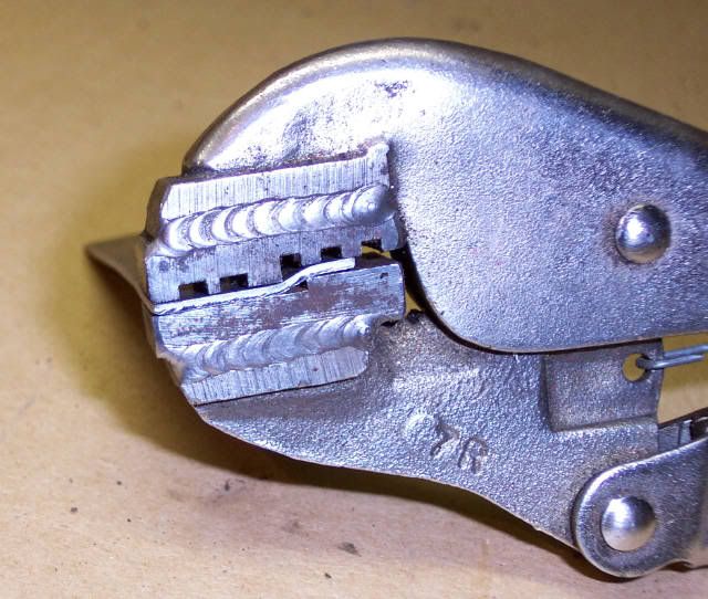

I have this tool that's a hole punch on one side and the other side steps the metal in so the 2 pieces of metal sit flush with each other.
Cool.
That tool is now on the list of tools I don't have, but want.

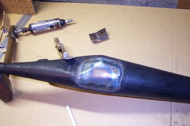

I borrowed these from my friend Dave when I had to patch a set of expansion chambers for my Kawasaki H1
That looks like to much work.
I was only doing small areas and since it's was round, warpage was less of a problem.
Plus them were to the point of either patch or throw away ( and I didn't have $700 for another set of chambers )
Good thing it's underneath and can't be easily seen
