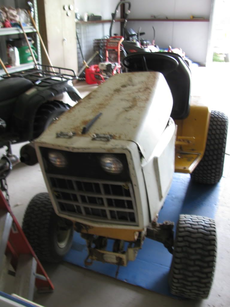

Yes, it looks like you have a 1572 from that picture.
Yes, it is a super and you can add a rear pto to it.

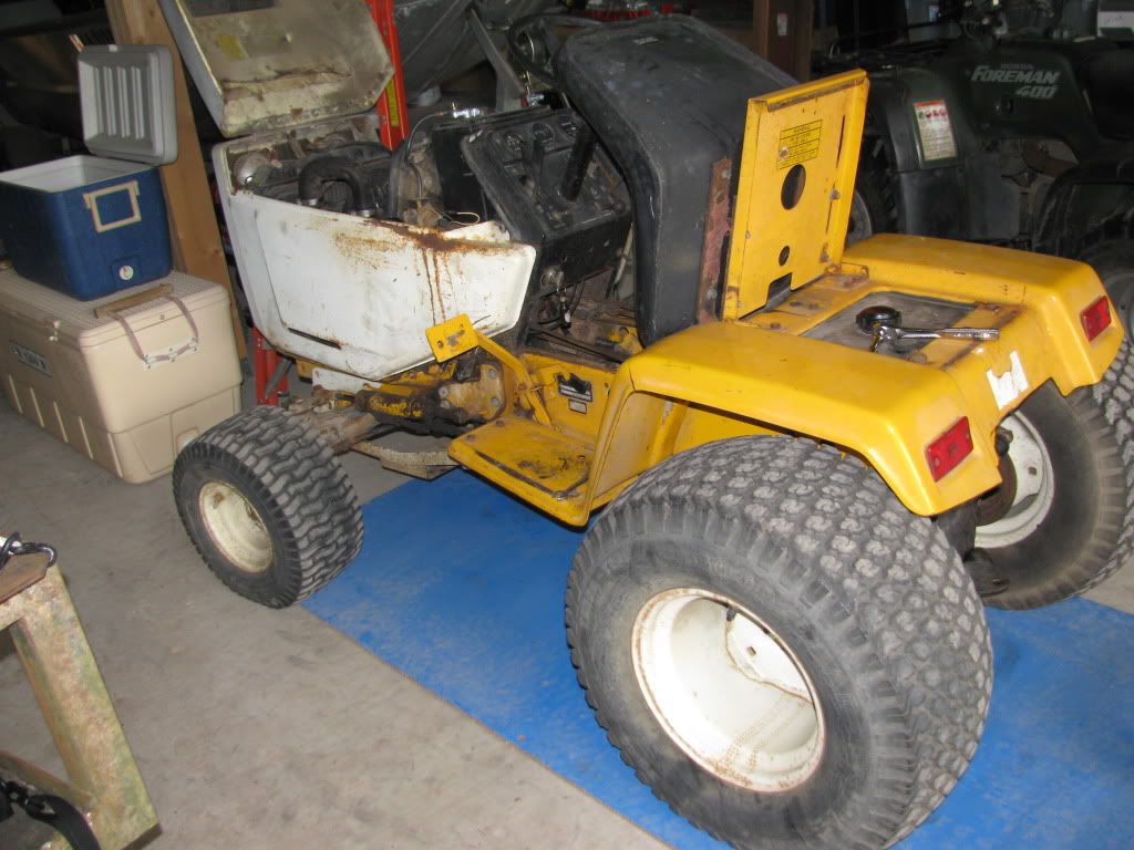

Here is some more pics, I'm sorta dumb, on the whole identification thing. I know that I have a '86 1572D, with a Kubota D-600, I also know that she had a mower at one time, but that rusted away, so he bought a Kubota TG1860, I know that the deck SN is 19476, What does that make it, i'd like to eventually get one, to make her operational again, I do have an extra Mule, the thing that holds the deck, and pully system, it's never been used, I think it might come in handy. I know she has front hydrolics.
So, it's possible to put a PTO on her, and get a 3 pt. Where exactly would I get the PTO, I saw some 3pts, but I think i'll just make that part. I've also seen grater blades that go infront, and belly blades, I think i might make something out of the other mule, that is a belly blade, not sure though.
Thanks again guys, I know I type alot, and ask a lot of questions. I thank yall for sharing yalls Great Abundence of knowledge with me.

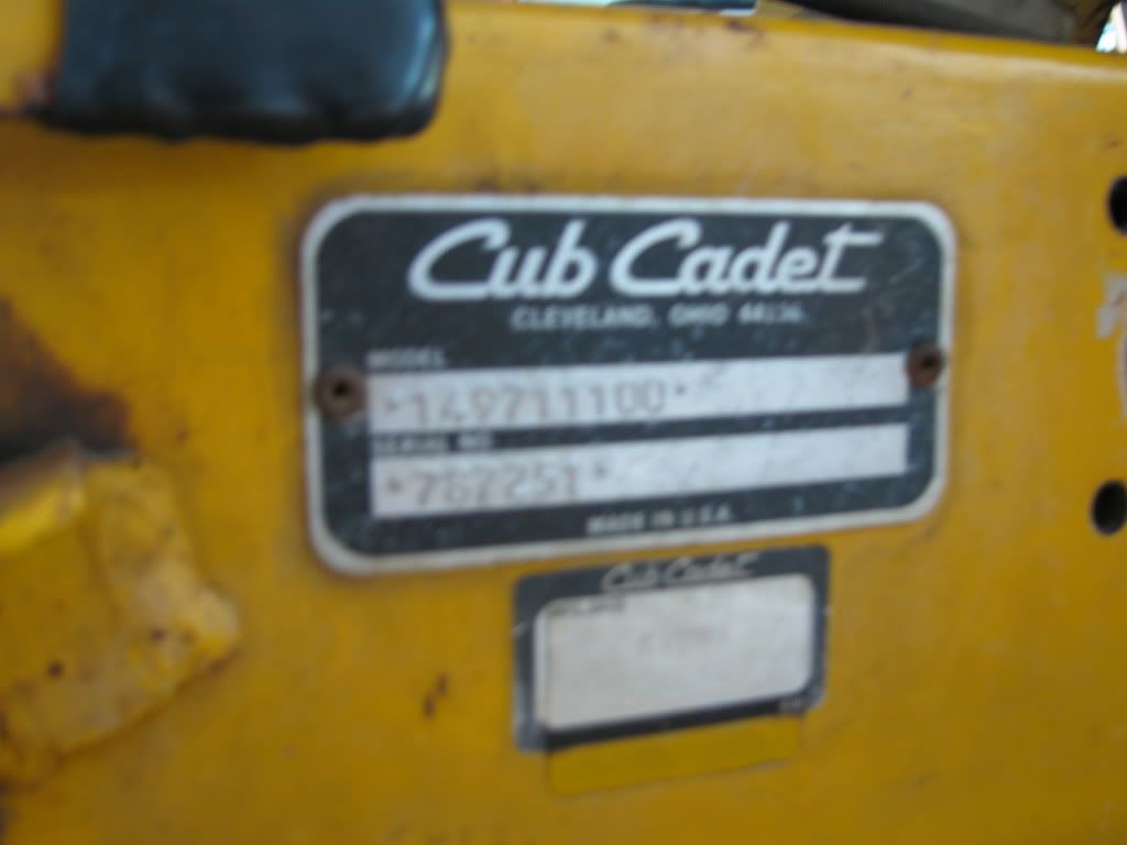

The info on the data plate : 149-711-100 , Serial Number 787251, indicates that it is a 1989 Model 1772 with the 17 hp version of that Kubota engine. All other info you have is correct and remains the same.
Take care and watch the bolts that attach the frame to the Cast Aluminum rearend housing.... They are notorious for coming loose and causing you great amount of grief. Get some good thread locker and keep 'em tight...and check'em regularly!!

Ok Myron, You say that it's a 1782. Matt said that it was a 1582, with a 15 HP engine, Julo had always said it was a 17 HP, so I'm hopping your correct, and that Julo was correct. Is there a place that translates the SN into a Model & Year. Just currious.

Cody: The OCC is the place where you get that data plate translated. I have the IH , CCC, and MTD/CC Cub Cadet listings and Matt G could have translated it also, had he seen the data plate before I did. There are also several others who here have the informnation, so here is where you ask.
CCC and CCC/MTD, like IH, changed the series digits when ever there was a styling change or a different series of engines...etc.
