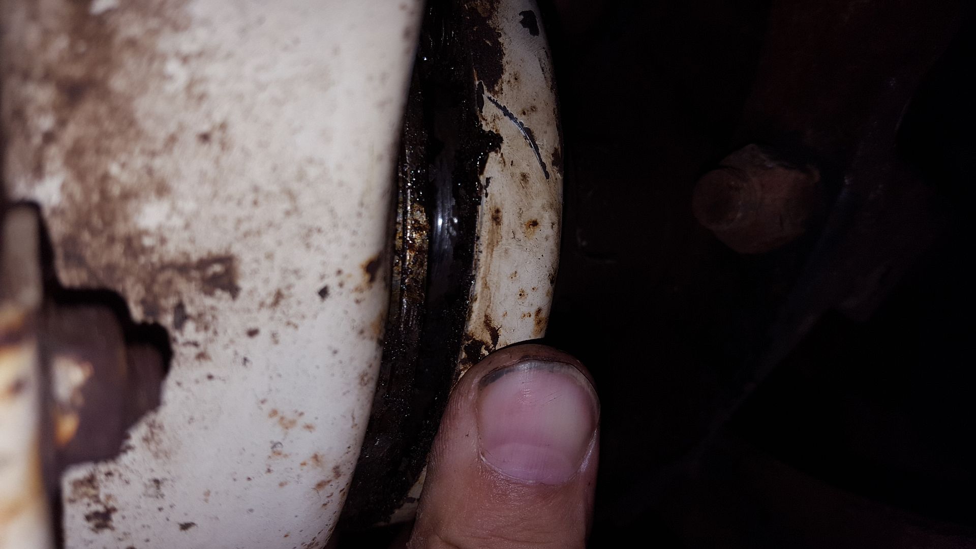

I see, that is possible something got in there. It wouldn't hurt to pull that cover back and see what drops out will it?
Old 09-01-2016, 02:37 PM
Posts: 18,873
It won't hurt. Go for it.

Couldn't get a good picture and it was difficult to see but looks like the only scarring is on the outside edge of the lock collar. That leads me to think its the set screw that came out and rolled around awhile. Nothing else was in there besides the felt and some dirt. I feel good about putting it back together and do some gardening with it now.
