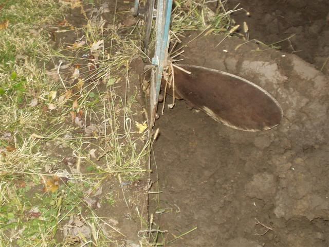

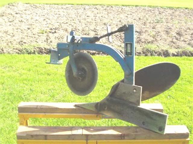

I'll have to take some more pics. There is 18" between the rear tires so I have it in Hole 2-R per the chart I found on-line. I'll have to try it in 1-R as the Brinly manual states though. I raised the left side onto 3 2x6's to simulate the proper angle. Set the plow so the landside is aprox. 1/2" off of the ground when the point is touching. These three pics are all I have right now. When fully raised the point is about 3-3/4" off the ground. You can see the plow appears to be too far left in the last pic and the landside is setting too high IE the plow is not deep enough, but setting it to run deeper makes it worse. BTW the right wheel is in the furrow from the first pass. I know it looks like I am trying to cut sod there, but it was a tilled garden last year and the soil is very soft and sandy so that should not be an issue. Is the furrow wheel weight going to cause me an issue? being so large?

You have the point set way too far down. (Trying to plow too deep.) Rock the point up... like, a lot.
I'd also suggest taking a flap disc on a grinder and taking the paint off the share and most of the moldboard.

You have too much point. The landslide should be no more than 1/2 inch above the bottom of the furrow.
Adjust the crank so the plow point is closer to the frame.

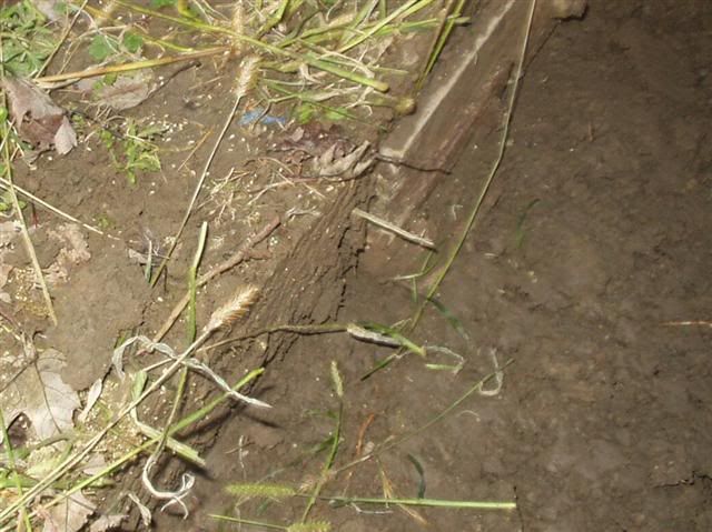

Here is how your landslide should look when set right.
The landslide is against the bottom and side of the furrow.
The plow is not a Brinly plow. This plow has a Homelite decal on it
