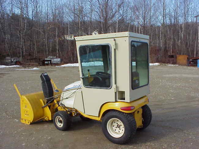

Yes Sims made/ makes a hard cab for it. The 2 stage snow blower is still available new from Cub Cadet and the front quick hitch and 54" blade are available on eBay.
You'll have to search or buy the individual parts for the hyd kit or kits depending on if you want 2, 3 or 4 hyd circuits.
One of my 3000 series tractors has the larger version of the Sims cab on it.

This is the smaller Sims cab, the seat would need to be way forward for it not to hit the rear window. I don't think Sims still makes the large cab anymore.
