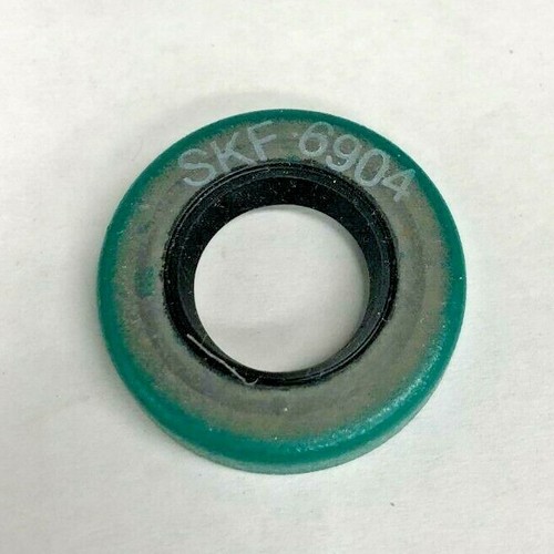

The input shaft seal is pretty easy to do once the driveshaft is removed. I used SKF 6904(MTD 921-3032) To remove the old seal, I used a drywall screw to grab it, then pulled it and the seal out. To install, I used a appropriate sized deep socket and carefully tapped it into the bore. Ensure that the seal lip is lubed with Hytran prior to installation. A dry start might damage the seal and the leak will return soon.
