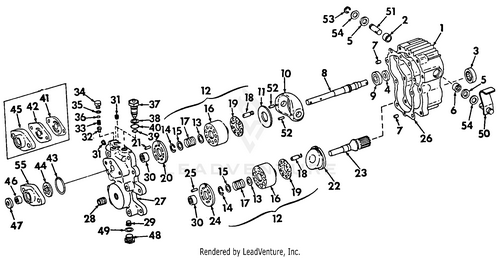

Check the front section of the transmission housing.
There are 8 bolts that hold it together,
4 of which are 2" long with the others being either 1-1/4 or 1-1/2, all 3/8" bolts.

Old 05-04-2022, 12:57 AM
johncub7172's Avatar
Posts: 3,103
First thing I noticed was that the bolt is worn under the head. Hood bolt? Axel carrier bolt? A bolt that wiggled out from being lost long ago? I don't recognize the bolt head monogram.
