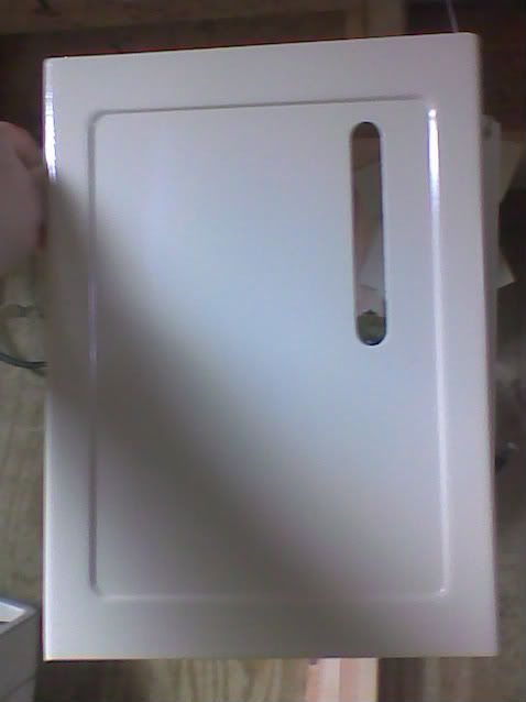

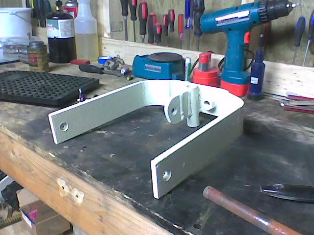

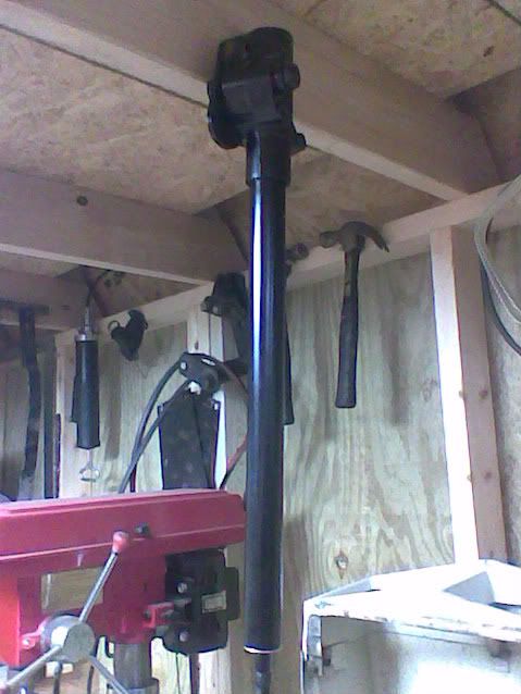

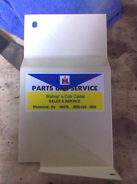

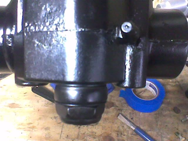

I got a few more things for my 128 finished up Sunday while it was nice out.
Steering all updated with the bearing and washers and locknut adjustment, Bearing to replace the plastic column bushing at top and all painted and adjusted. It is Super smooth.
Super Steering Upgrade I got from Mark
Steering shaft top bearing
Finished product
Side panels painted and my Repro dealer Decal installed
Tunnel Cover Painted
Sleeve Hitch Painted
