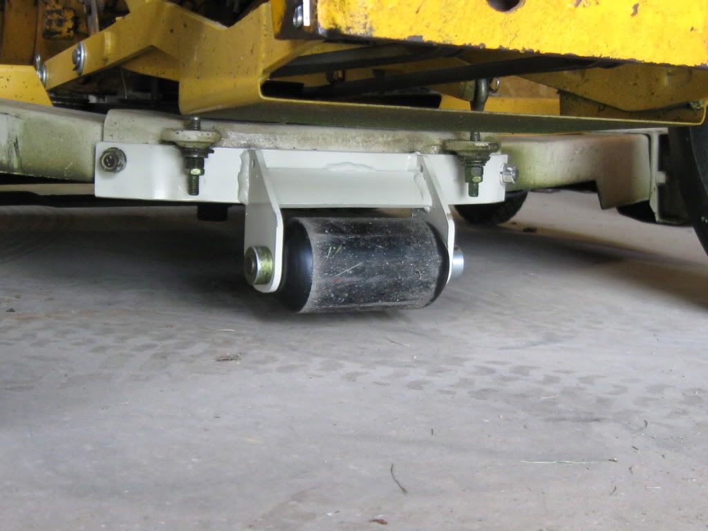

Over the weekend, I painted the 3-point and sleeve hitch adapter on the 126 and painted the front roller I made for my 42" cast end deck.
I also decided to make a sleeve hitch mount for my fertilizer/ salt spreader. It's just mocked up in the pic.

I love the fertilizer spreader on the Brinly IHinIN!! I've always wanted to make something like that but I haven't gotten around to it. Call me stupid if I'm missing something but I couldn't tell how you're gonna run it. Will it still be ground drive? I might see if I can rig up something like that.
  #3235
Old 07-01-2011, 01:05 PM
I am betting he does an electric motor to engage the thrower. I have seen a few done like that. Very nice and easy to do. I would like to make a bracket like that to fit an electric sprayer onto. Would be much easier to spray all of my fence lines like that.

I'll be using a motor and gearbox from a cordless drill to run the spreader. When I first built the spreader, I mounted the motor underneath. That was a mistake though because the salt draws moisture and it ran down inside the gearbox and rusted the gears together. This time the motor will be on the top. I also have a rheostat I'll be wiring to the motor to control the speed of the spreader wheel. The motor I had before was too slow with the gearbox in low range and too fast in high range.
