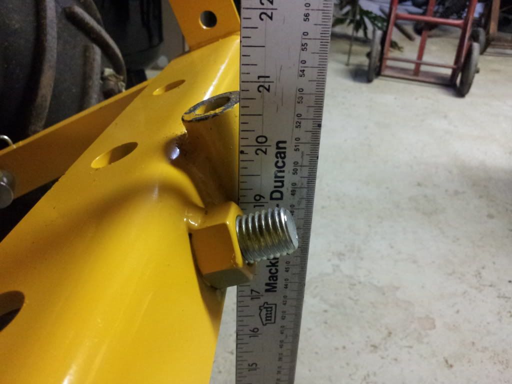

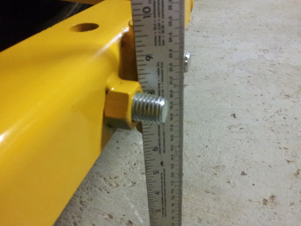

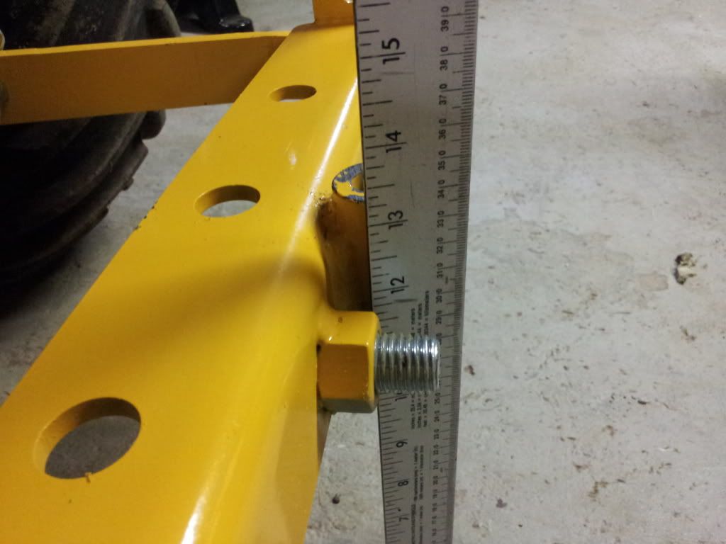

I had some requested for measurements so here are some pictures. This is not the full range of the lift because the multi configuration allows for several possibilities this is just my current set up.
Full up
Level
Full down

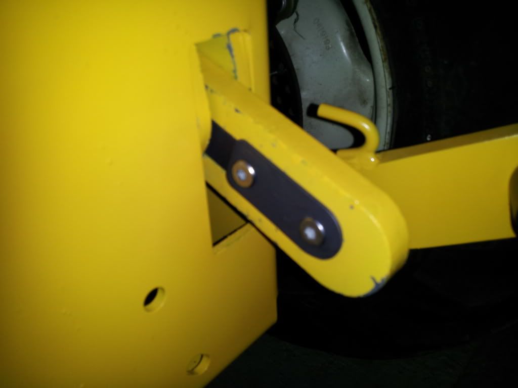

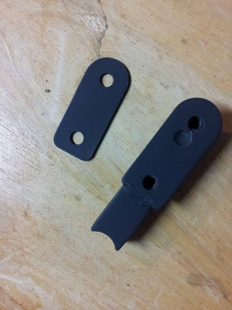

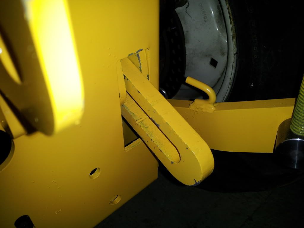

With the stock set up from Xtreme on a 2284 you will have 0% down pressure becuase of the long float slot see picture.
I sent an email to Aaron at Xtreme and he quickly answered with a few options. He was great and did not make excuses or try to sell me something. His design is based on the OEM design so the float is a stock set up. He mentioned a prototype float block he was trying and offered to sell me one. I purchased the float block,painted it flat black and installed it and now I have 100% down pressure. If I need to float I just remove the block. Here are some pictures of the float block set up.
