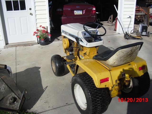

Some more pictures as I did some repairs and tuned it up:

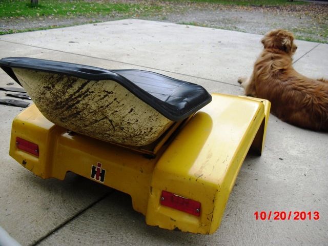

Seat and fenders off for examination

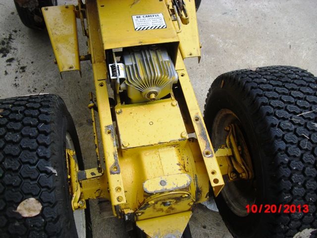

After a good power washing to remove the layers of grime.

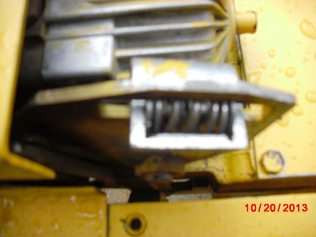

Sorry this is blurry but you can see the slots wore in the trunnion. I repaired this by welding on a strip of steel.

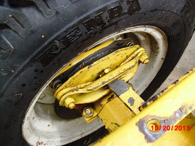

Shot of the brakes, they look new.

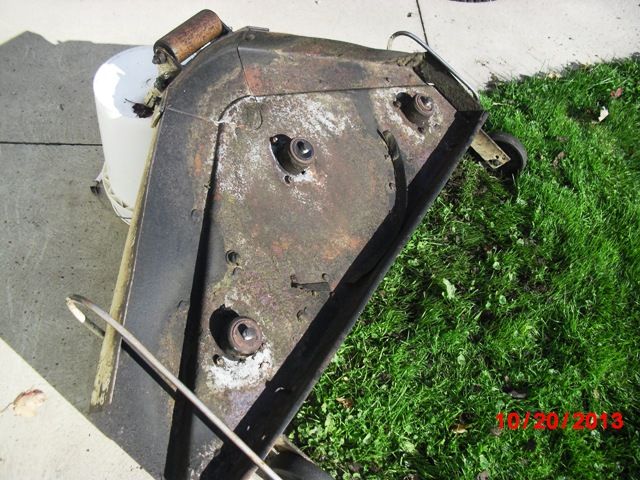

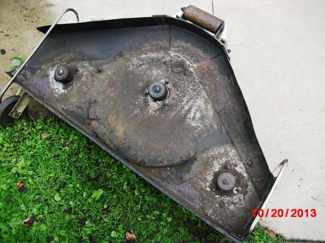

Deck was real good for the age. No holes, no patches!

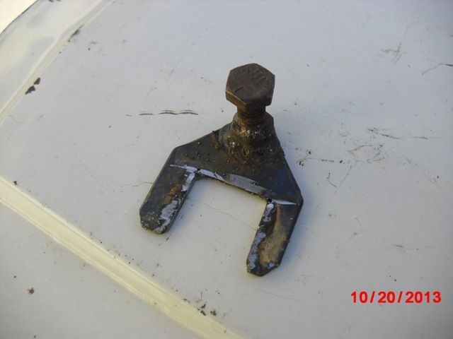

This is the crows foot wrench I built to get behind the steering column and tighten the nut for the shift lever. Doesn't look pretty but it worked!

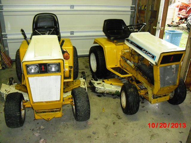

Seeing double? The new one is on the right.

nice work, whats the one with the headlights

The one on the left is a 127 also. I purchased this awhile ago from my aunt, so its a family tractor. Has manual lift, and sleeve hitch. Eric rebuilt the engine and painted it a few years ago. I have been using it to mow the 4 acres.
