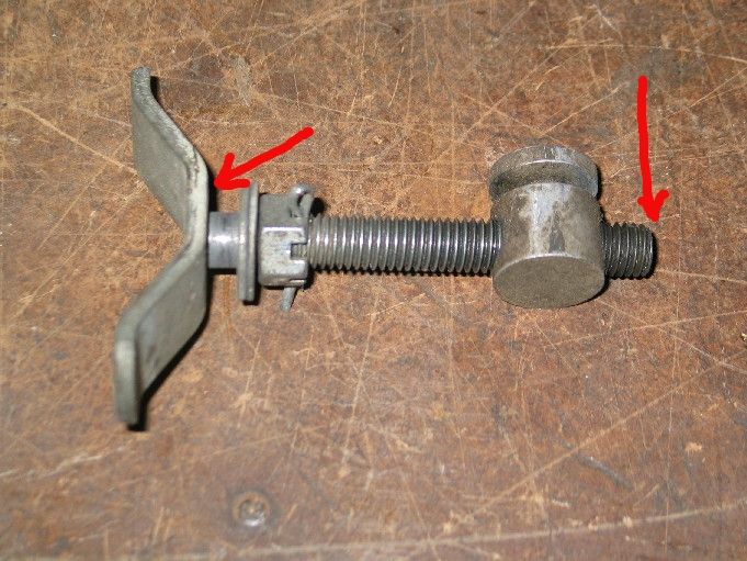

that IS reverse thread and that castle nut makes sense because there is a hole for it which is not the case with the adjuster I have. I'm starting to think I got a little hosed on this snow thrower from craigslist. The belt I was given was too big, the lifting rod was too short. now this...

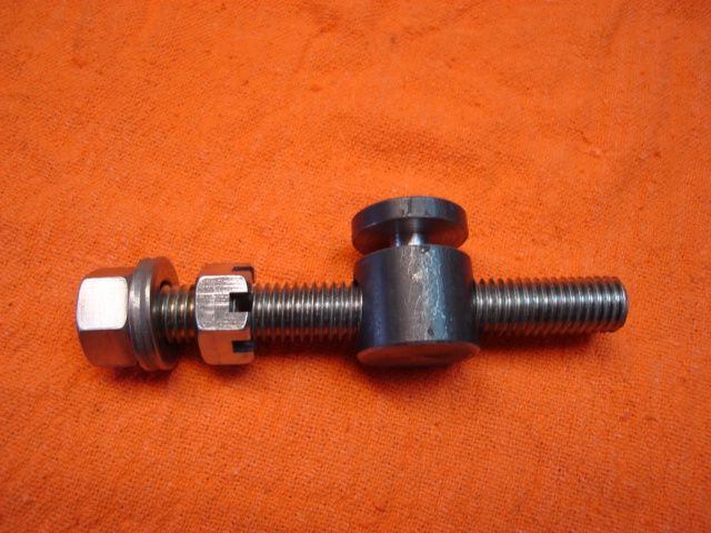

I purchased material, I have begun machining and will be offering these shortly.
Jeff
Is there a way to incorporate some kind of socket head on it to make it able to be turned with a wrench? Even a nut to put a socket on or even a female socket adapter (like the fill plug on older Cub rear ends have) would make it easier to get to from time to time. Just a thought, looking forward to seeing what comes out of your shop!

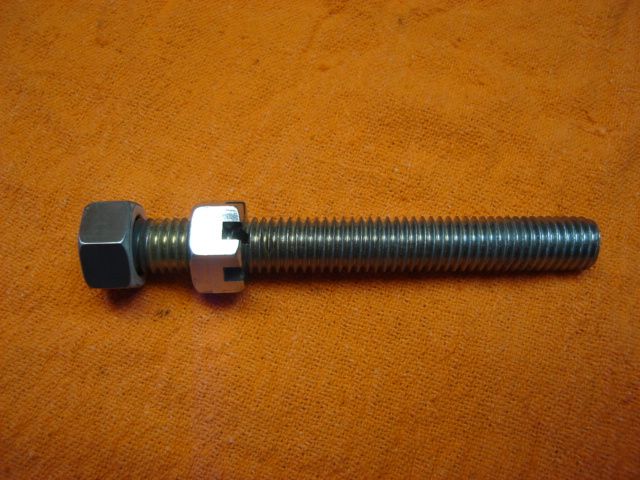

Got the first few done
QA36 / QA 42 / QA36A / QA42A belt tensioner bolt, castle nut & plate button . This style has a welded nut in the end for use with 3/4" wrench. ( original style will offered later after I bend up handles)
These are 1/2 -13 LEFT HAND thread
I'll also sell just the bolt and castle nut too
Complete unit as shown $27 plus shipping
Adjustment bolt with castle nut $15 plus shipping
Plate button $15 plus shipping
I put this in my parts for sale post too.

I like the idea of being able to put a wrench or socket on it to adjust. In fact, on one of the ones I have the PO welded a large nut to the adjuster wing - just throw a socket on it and can turn it to however tight you want.
