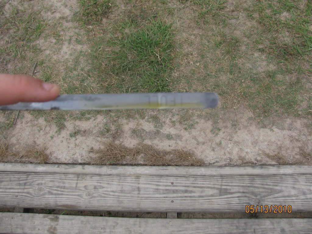

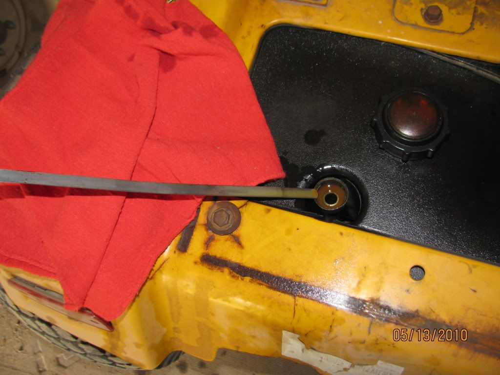

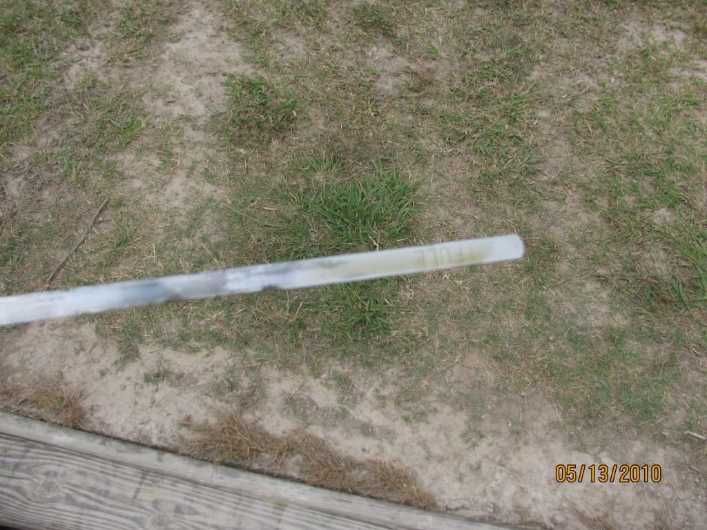

Yea, yall know how I said I put oil in last night. Well I went to start her just now, to spray the yard, with the spray rig. Well i pulled the dip stick, and there is about 2 inches above the full mark, or about 1 inch above the last L in Full.
Is it bad to run it with that mutch oil. and i'm going to assume that you check it before running, or durring so that the oil is at the level it will be while running.
Please Help
Cody

You can't check it while running....with the tractor OFF, pull the dipstick out, wipe it off, and then put it back in and pull it out. This is the correct level.
Any extra will probably come out the breather.

what kind of hydro fluid did you use? The fluid setting on your fill tube looks pretty nasty.

@ Matt. Ok, then it's way over. I need to drain it. Besides removing the rea pannel, there isn't a way. I looked, and don't see any hole, besides maybe removing a bolt from the bottom of the back cover, will oil come out, or is it in a solid piece.
@aagitch. I used the cub cadet hydro oil. It looked fine when comming out of the leaking seal, so I just added some. Not a good idea it seems. As it is very white, and not clumpy, but it wants to stick together. if that makes since

I haven't had to glo it for that long since i've had it since February so that's probably why I haven't heard the click. You can drain most of the fluid from the plug at the front just below the hydro filter. Then take the rear cover off and replace with new gasket. If you don't already have the service manual, they are available on pdf. If you want let me know and I'll email it to you. I didn't know jack about the smokers til a few months ago but reading manuals front to back helped out alot. When I have my headlights on, it shows a discharge unless it's at full rpm's. I was wondering if that's normal too. Maybe someone else can confirm if that's normal. I think I priced a new one from a couple places on epay for about 120.00.
