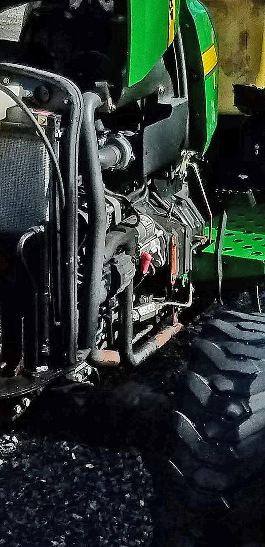

Saw this at a show, they did a good job. (Sorry about the size, can't get it any bigger)
