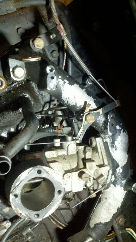

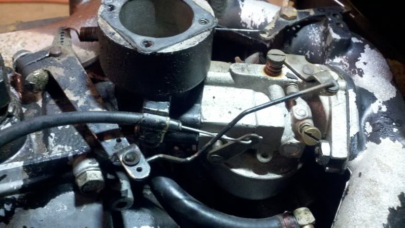

Here is how the linkage on my 1811 is hooked up
Congrats on your new Cub!

Look at the pic I posted. Your linkage looks like a piece of wire, bent to work.
Glad you got it running good!
It sure does but I already knew that. I thought you were talking about something else. Going to order a new piece tomorrow seeing as they're only about $5.
Awesome, thank you so much for the pics!! Judging by your setup, my governor spring still needs to go to the end holes. Otherwise, I think I got it right. Thank you guys so much for the quick help!!
-Ryan
I wouldn't put it in the end. Second from the end, is the starting point. The farther you move it out, the less sensitive it is.
Hmm...well, that leaves a bit of a head scratcher then. As it sits right now, when I go from idle to say 3/4 throttle in one quick move, it revs and works like it should. However, when I go from idle to 3/4 throttle slowly, it seems hesitate or studder for a second while it revs up. Any thoughts on this one?

J-Mech is right. The holes are just for fine tuning and the second from the end is where I usually start. The pics I posted are of mine as it was when I bought it as a non-runner. When I get the engine rebuilt I will adjust the linkage as needed.
And I ordered the proper governor linkage yesterday and a couple other little things, should be in by the end of the week.
That has nothing to do with governor position. Probably should pull the carb and clean it/ tune the motor up.
Governor sensitivity example:
1.) You are blowing snow. You plow into a pile, the motor pulls down, but doesn't try to pick back up. Pulls down more, then starts trying to pick back up. Or, same scenario only it pulls down immediately and too far, then tries to come back. The governor isn't set to be sensitive enough.
2.) You are using your tractor out in the yard. Half throttle pulling a trailer. Every time you move the hydro handle the engine jumps up in RPM and really comes to life, then immediately calms back down after the initial movement of the tractor. Governor is set too sensitive.
