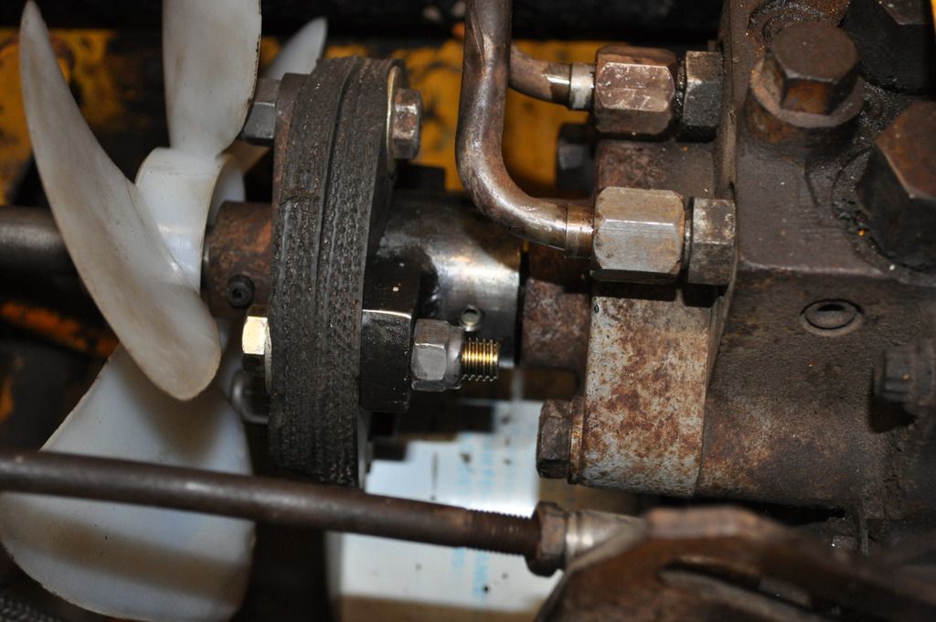

Tuesday the rest of my parts will be here straight from cub and i can finally rebuild the drive line. 4 new flex discs, all new hardware, 2 couplers, 2 new self aligning bushings and a used pump.

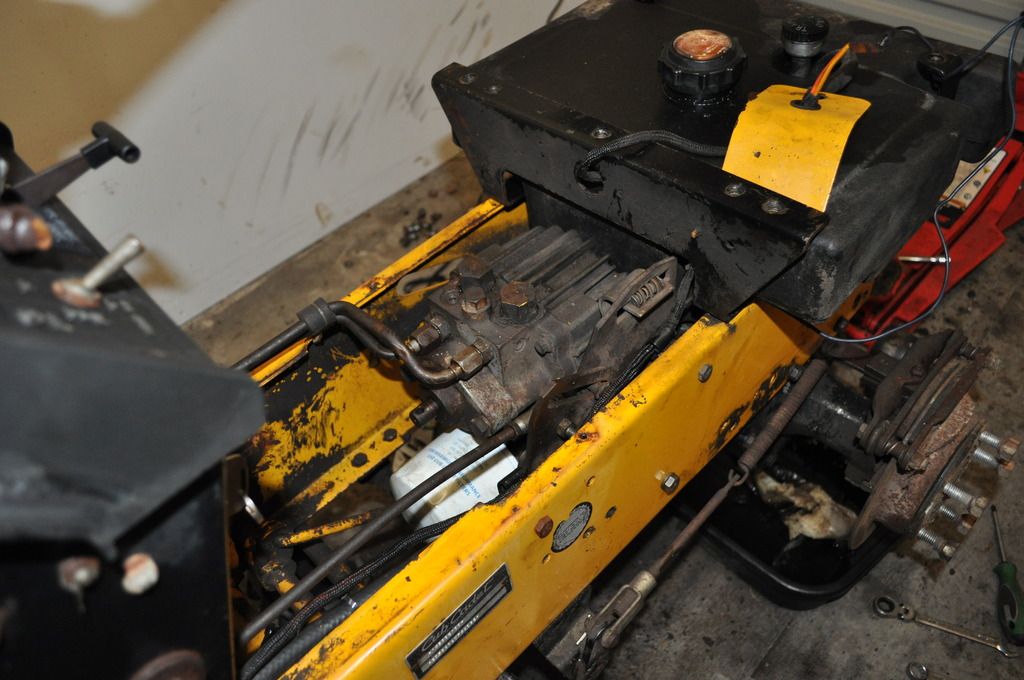

Today i took the 1512 for the local car wash and cleaned all the dirt and grim the best i could. I removed the transmission and pump tonight tomorrow i'll install the used pump and new gasket and get the rear back in the frame.

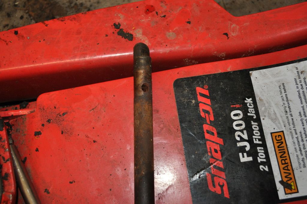

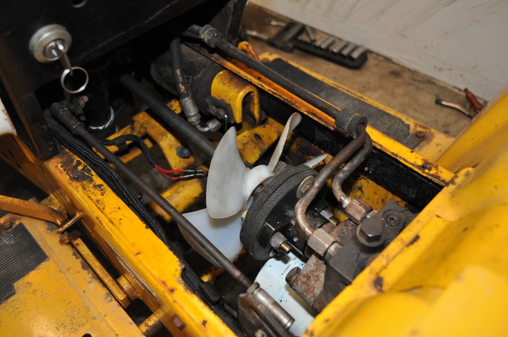

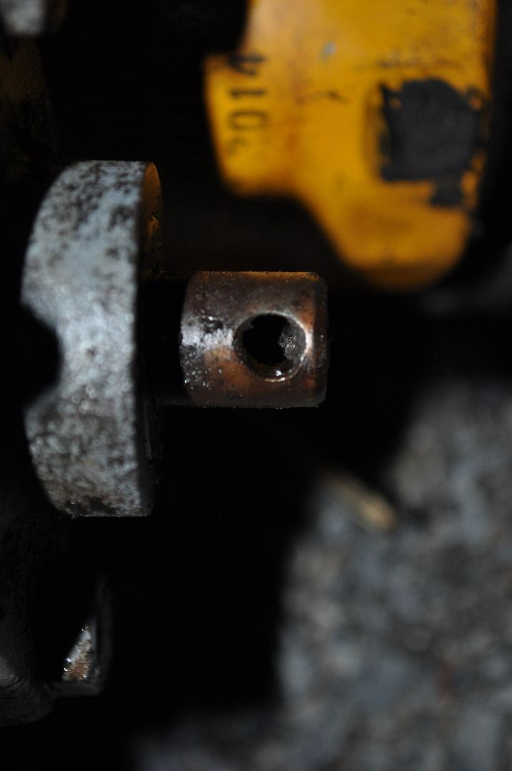

Well i've gotten As far as i could can without my orders come in this week.
Here are some pictures of the old input shaft and front of my old driveshaft has a nice bend to it.

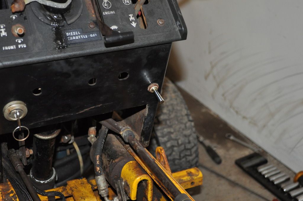

I got the new Belts installed, New light switch, new head light bulbs, got the used pump in. I also took the time to adjust the brakes and hydro lever.

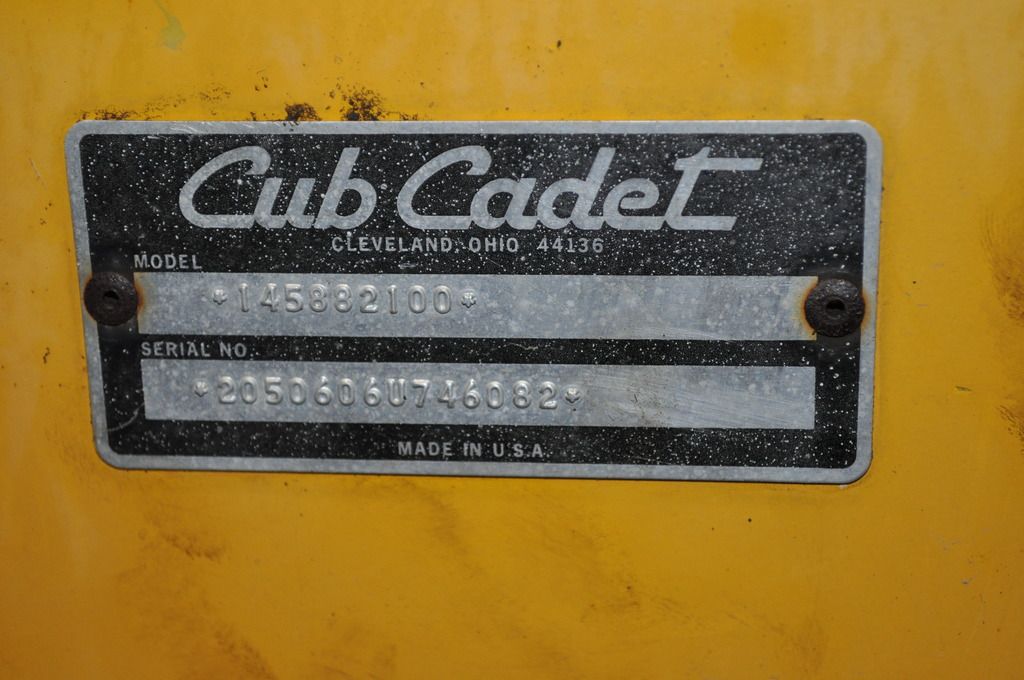

Finally last it turns out my 1512 is really an 882 with a 1512 hood never checked the serial number till today.

It's a 1512. Even the 782D came with the 882 on the serial number plate. The difference is in the kind code. Looks like you are making good progress. Nice work.

Looking great!!
Those diesels really beat hard on the driveshaft as you have found already!!

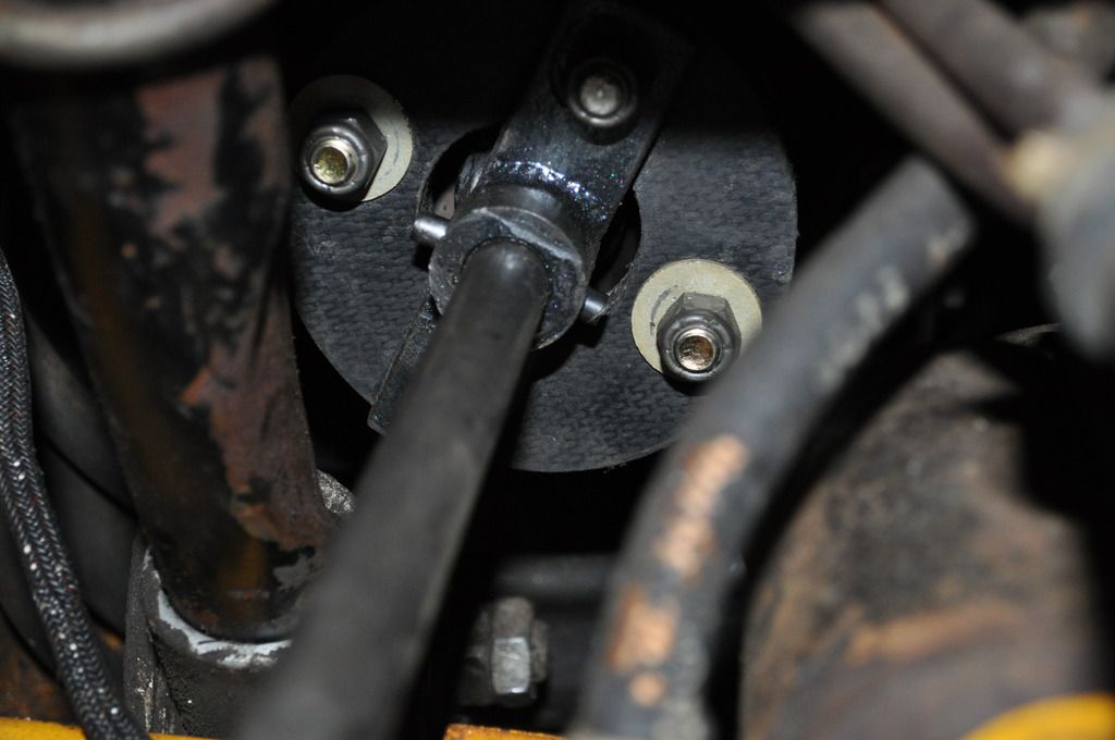

Installing this driveshaft with 4 new flex disc was something that almost broke me but i managed to get it installed with out loosing my cool tonight.
Managed to get the drive line, The hydro system filled and bled the air out. installed most of the body work installed.
I had a little chance to run this tonight it was 10pm so i was able to work the lift and move it forward and backwards in the shed. I can't believe how smooth this thing feels when it's running correct.

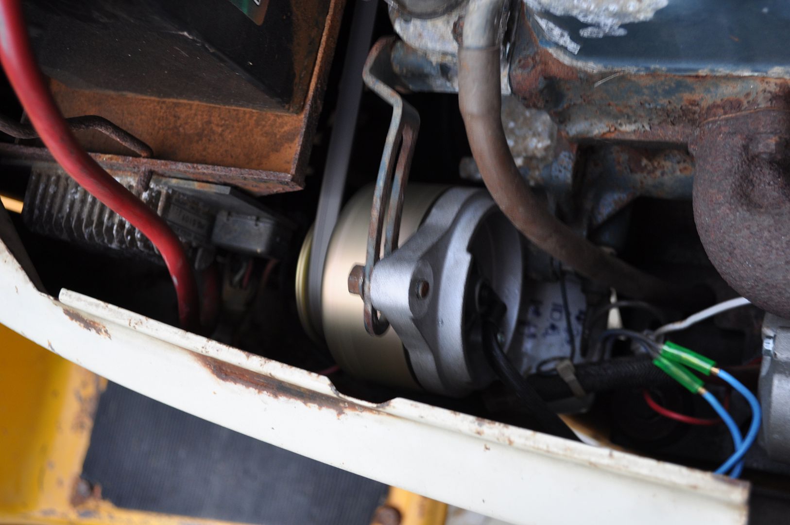

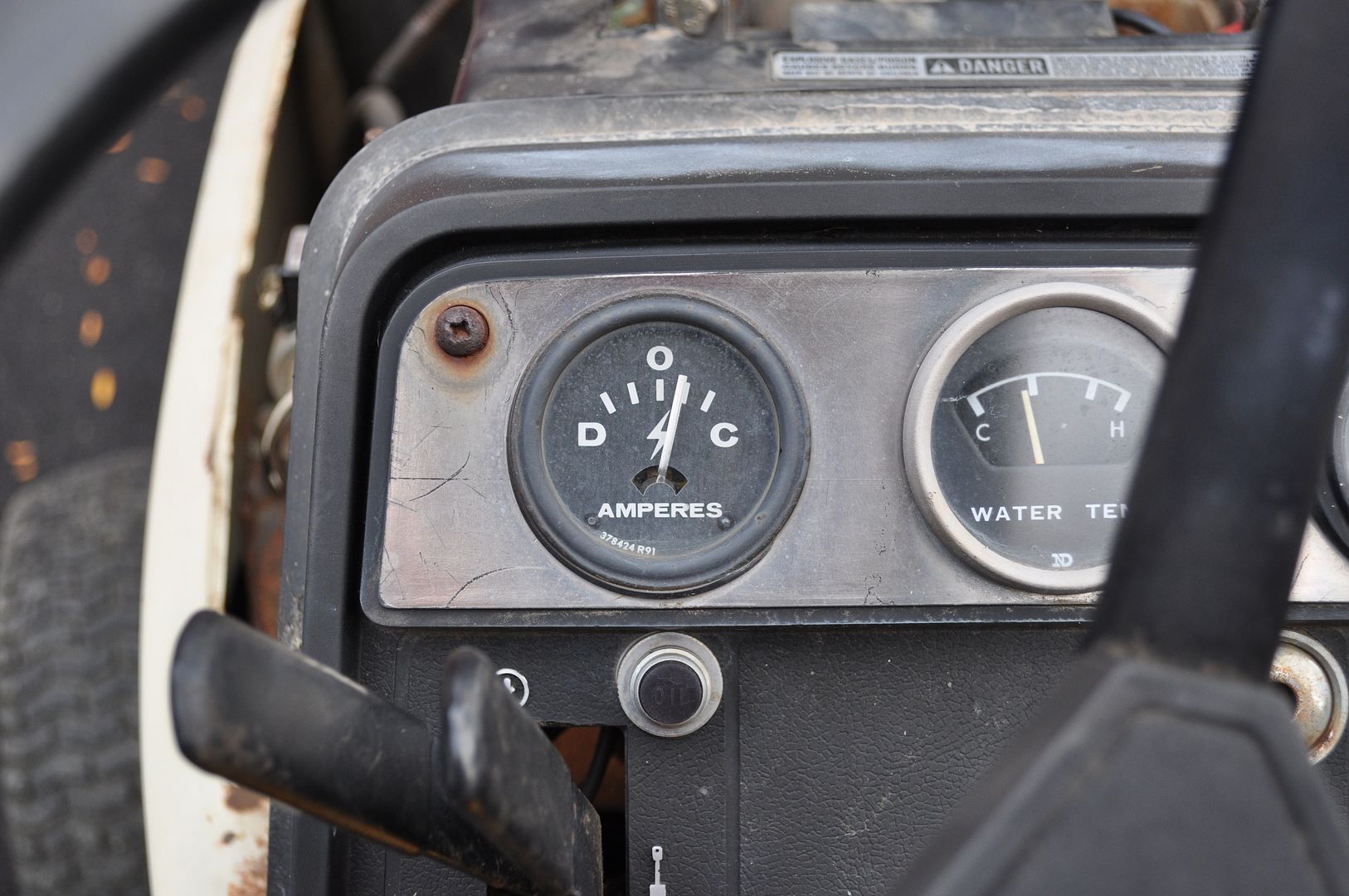

Recently i was having issues with charging and starting, I replaced the ignition switch with an oem kubota one and that solved my starting issues. I replaced the alternator with an aftermarket one and that seems to be just fine as well now.
