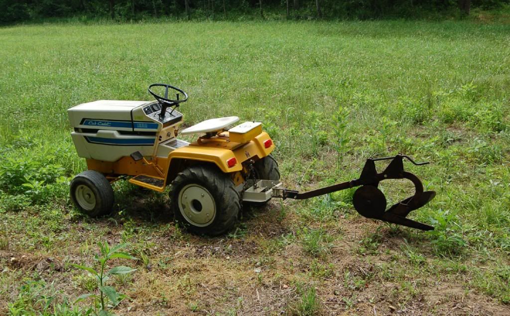

got the plow attachment all fabb'd up and tested her out..works great..
