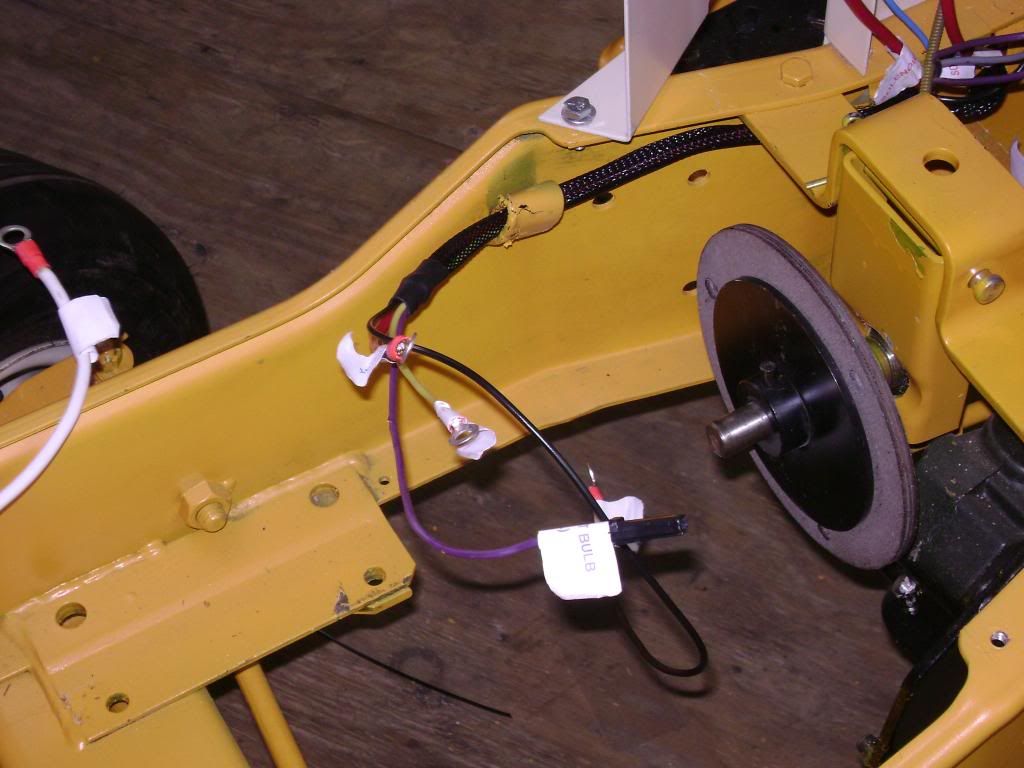

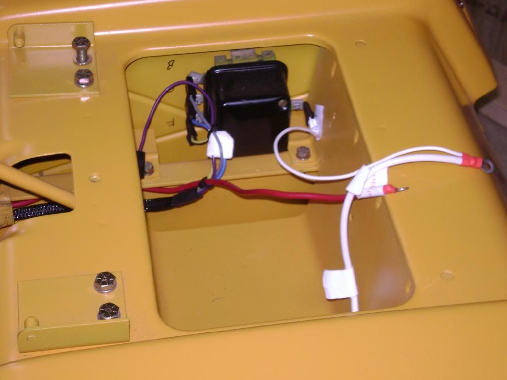

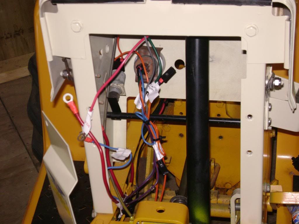

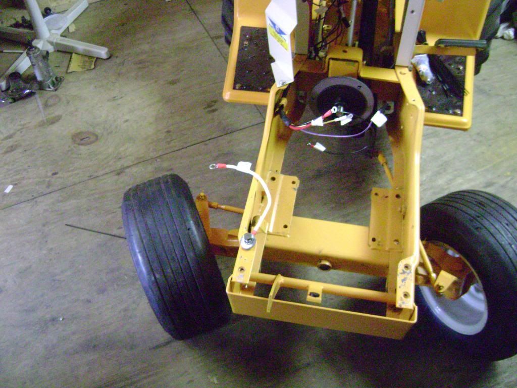

My wiring harness from Mike Lamar came in today. All I can say is wow, he makes a heck of a nice harness for a great price. Includes every wire that you could possibly need. It took me all of 5 minutes to install it, due to his quality touch of labeling each connection and where it needs to go. Here are some pics of the harness and what it looks like installed.

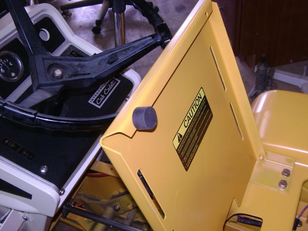

I also found a great use for a QL engine cradle snubber. I only had the one. If anyone happens to have one they wouldn't mind donating to the cause I would be very appreciative.

Looks great Dwayne! Mike does nice work!

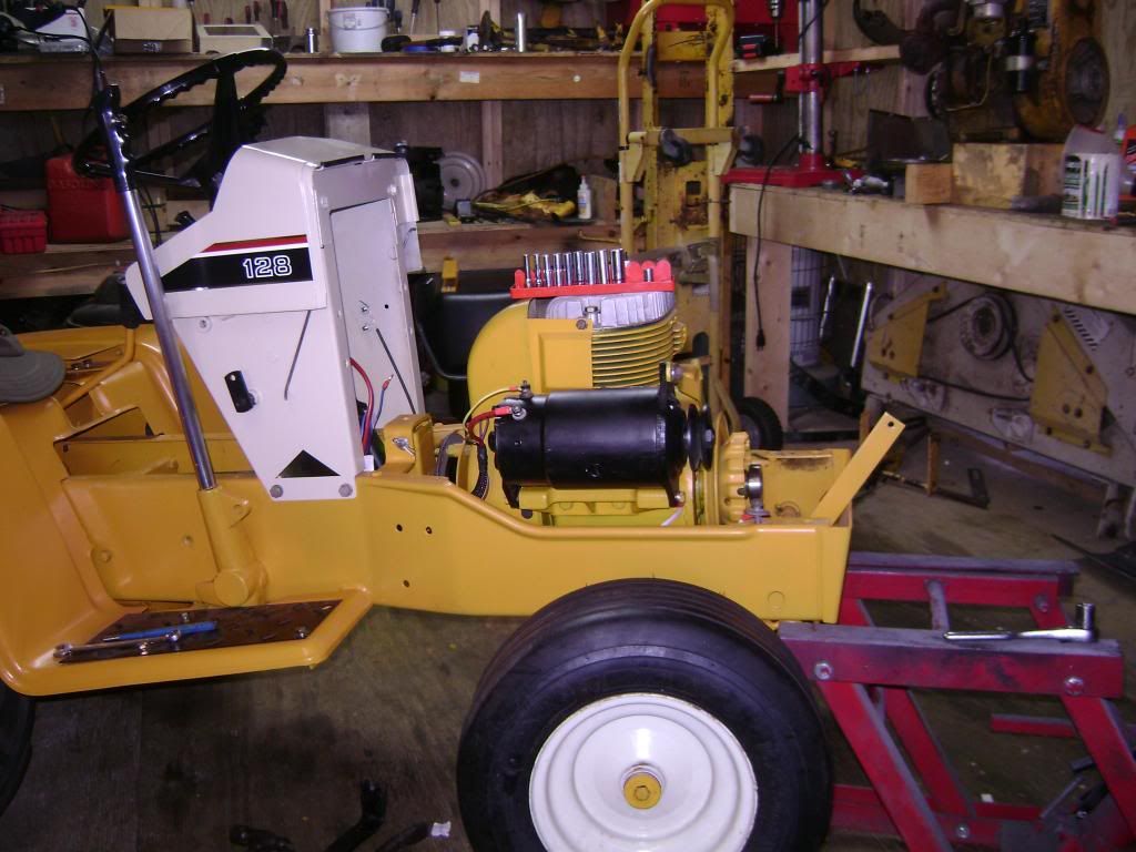

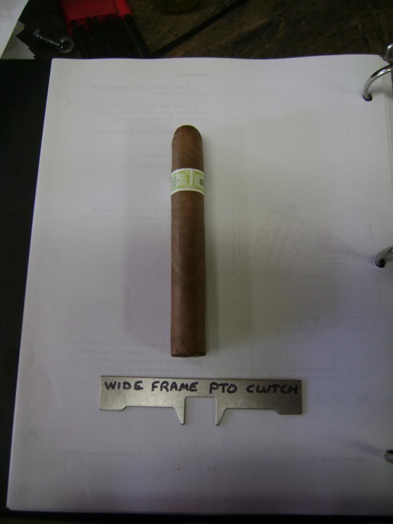

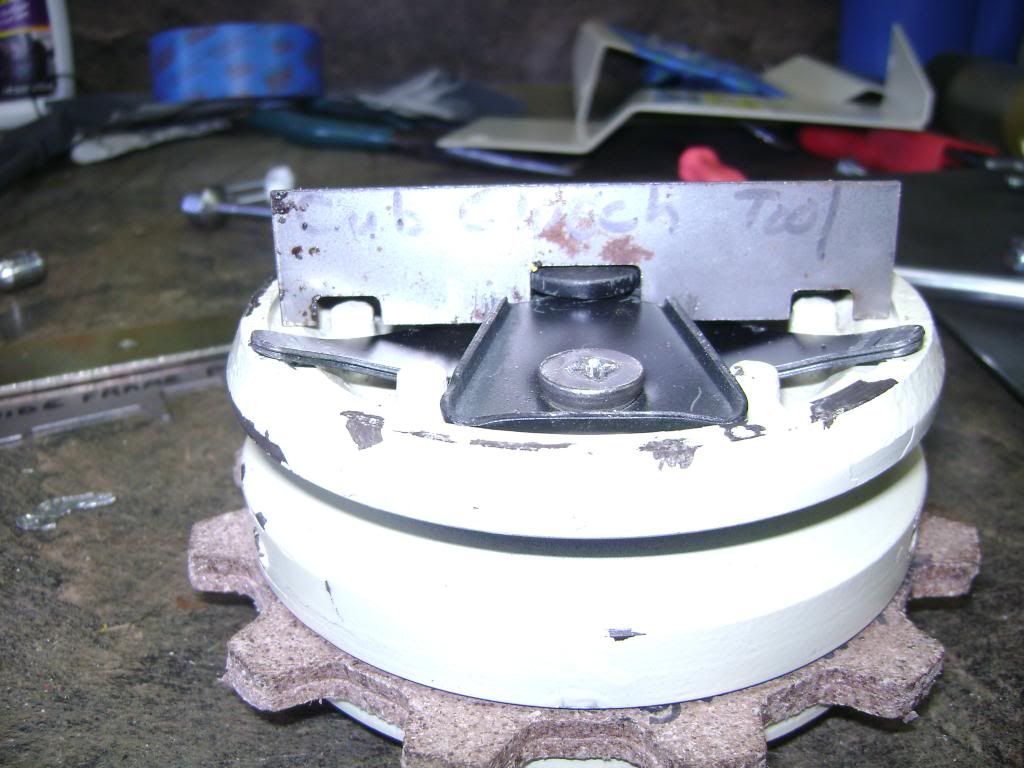

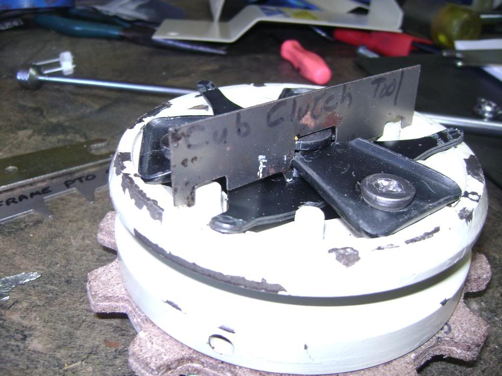

Time for another update and some pics. Roy Najecki was kind enough to send me a WF PTO adjustment tool. Again, thanks Roy. Will have some money headed your way Wed. After Adjusting the PTO with the correct tool, I thought I would check it with the NF tool just for giggles and see how much difference there would be. Guess what? Both tools showed the PTO being adjusted perfectly. Both of the ends of each tool along with the center points touched exactly the same, with the difference being the WF touched the outer shoulder of the plate and the NF tool touched the inner flat area of the plate. So, if I am correct in thinking, one should be able to use either tool to adjust a WF PTO. I can't comment yet on weather or not you can adjust a NF PTO with a WF took, but I would think so. I have some pics of both tools set up after adjustment. Let me know what you think.
First, the motor installed and bolted in.
The correct WF PTO Tool. Disregard the Cigar

PTO Correctly adjusted
PTO correctly adjusted with the NF Tool. As you can see it seats perfectly too.
Another NF tool view

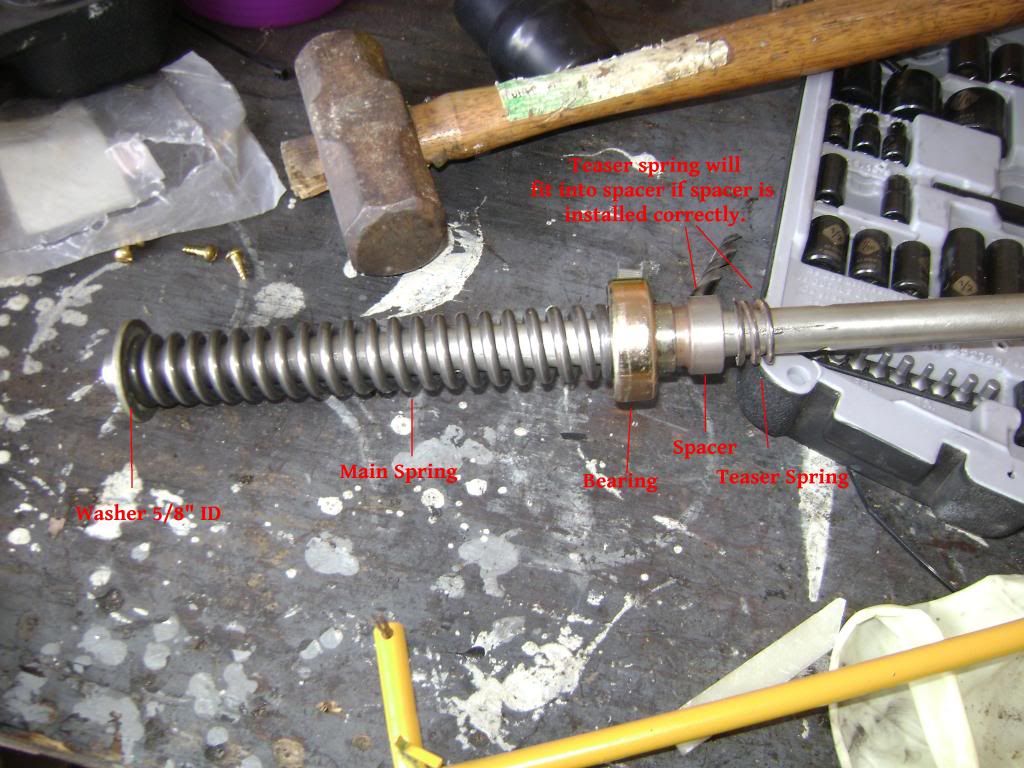

I thought I had my clutch all put together correctly going by pictures of the old one, and then I come to find out thru the parts diagram there is a spacer that fits in front of the release bearing and behind the teaser spring. I ordered the part and got it put on today. I thought I would post a picture of the Clutch spring components and show the order they go. This would have helped me a bunch. Come to find out, that whoever rebuilt the clutch on the 128 in the past did not use that spacer.
I have that exact same precision tool! Nice to have the right tool for the job!
Comes in handy for many jobs.
