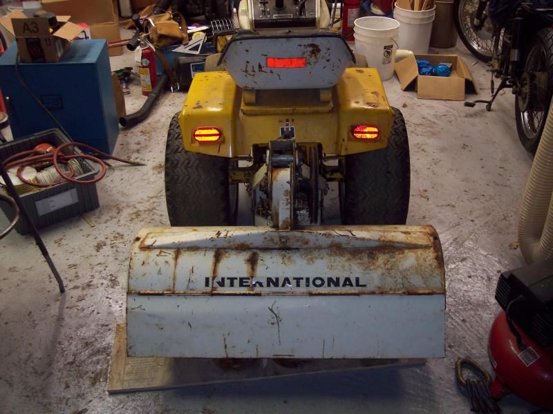

20 ton press maxed out then heated tines to orange still had to press all the way off but finally apart-now for reassembly.

This one has been a battle. Sounds like you have it on the run now.
I'm thinking it may be a good idea to pull the tines off when your done using these things, clean the tube out and put some never seize on them before reassembling. I got lucky on my 1A and the 400, both came off with a big puller and a 1/2" impact wrench.

I had 3/4 impact on a puller, tried a torque multiplier, all with the tube orange, we put snow on the inner shaft to cool it, and nada. Finally took off some tines, put it in the press and back to orange. It gave up then.
I hope to never need the tines off again, but they will be slathered with neversieze. I wonder if a plug in the tube end would help.
