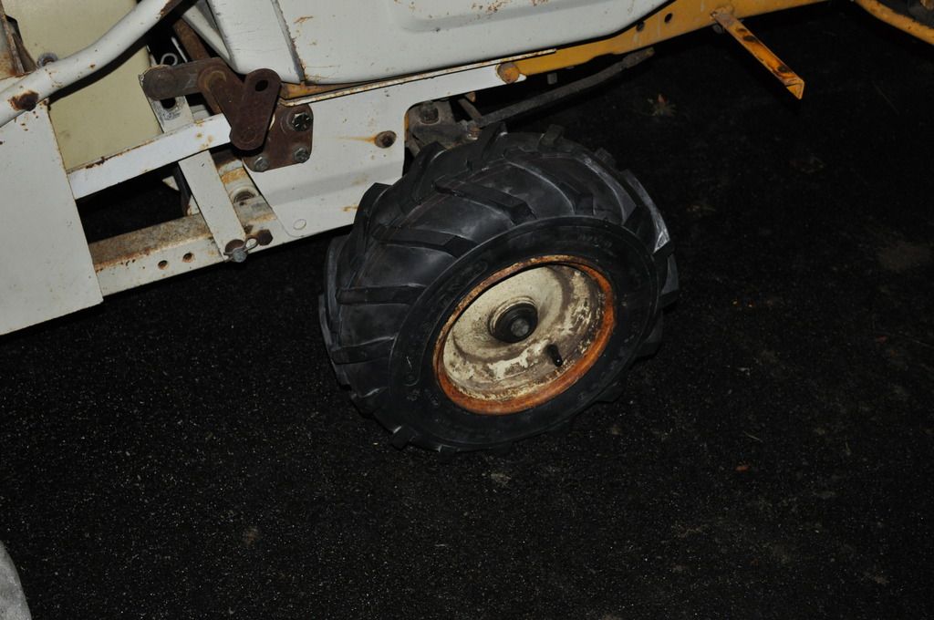

Last week i put new deestone 4 ply ags on the front i wanted something that would hopefully bite and help me steer with the 450 blower on.

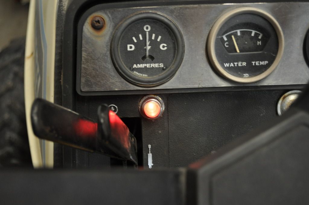

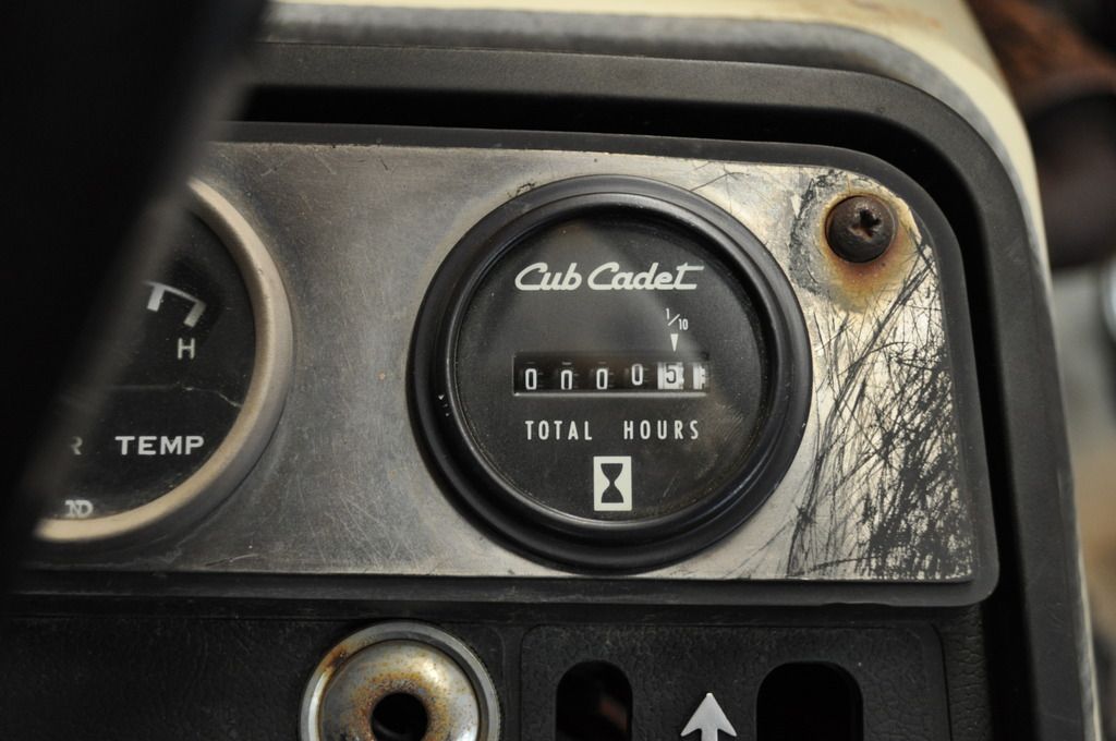

Today i installed a new hour meter to replace the broken one and i replaced my oil light as it's never worked since i've owned this.

On snow and ice, tread doesn't matter. All that weight, you can steer it just fine with turfs.
You mounted them backwards. When not a drive tire, bar tread should be mounted the other way. Flip them side for side.
I'm certain you'll get kickback, but thanks for posting this! I see so many mounted the wrong way.
It's not always driven/not driven though - it's what you want the tire to do. We would mount the driven front bar tires pointing rearward (opposite what you normally see on a farm tractor) on our mud racers to get lift. Driven Tires mounted the normal way will dig down looking for bite. We didn't want the front end digging it as the vehicle would be propelled by the driven rear paddle tires. So the "backwards" front tires, driven a little faster than the rear due to different tire height and gear ratios, actually kept the front end up and out of the muck.

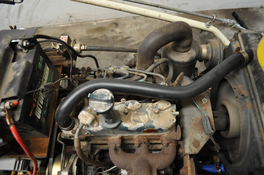

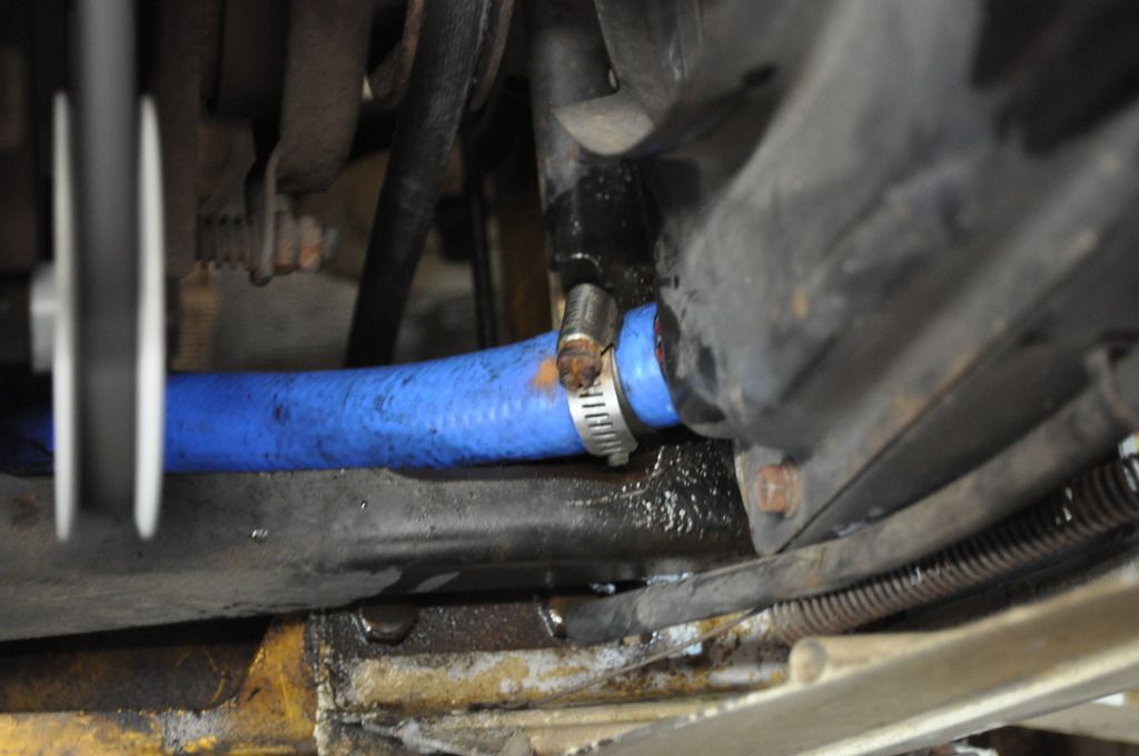

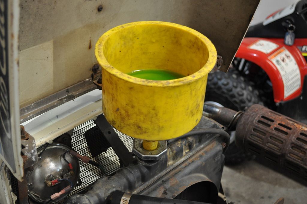

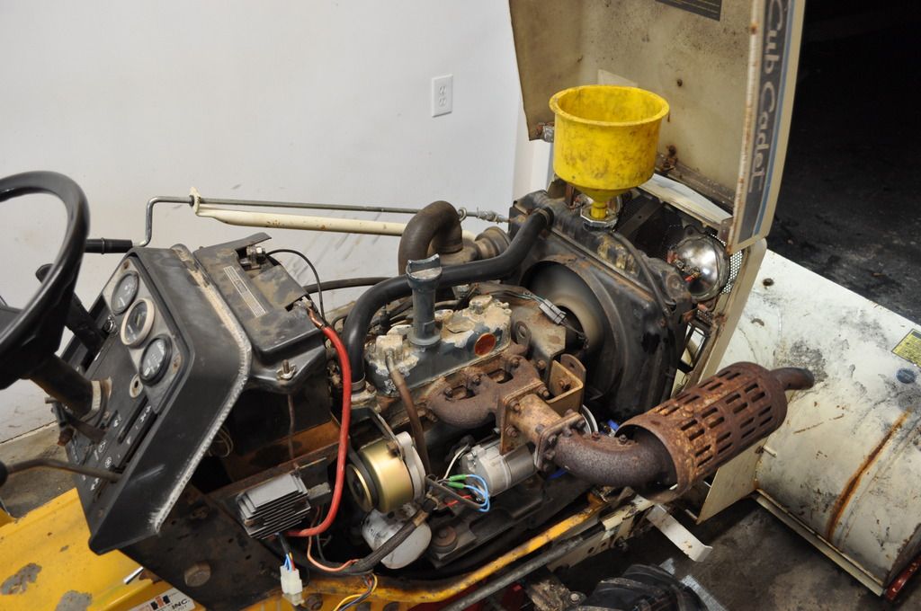

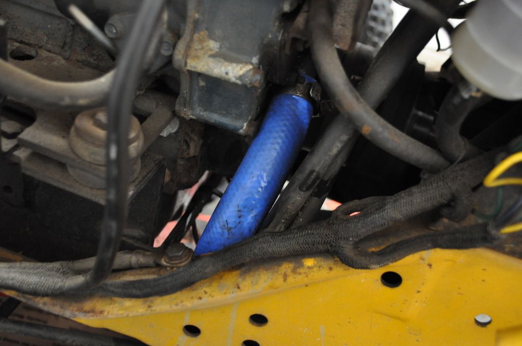

Last week ordered 5FT of silicone heater hose to replace the lower hose and ordered the upper hose from an RTV. So today was the day to get it done as it was fairly warm outside. The old hoses were hard as a rock.

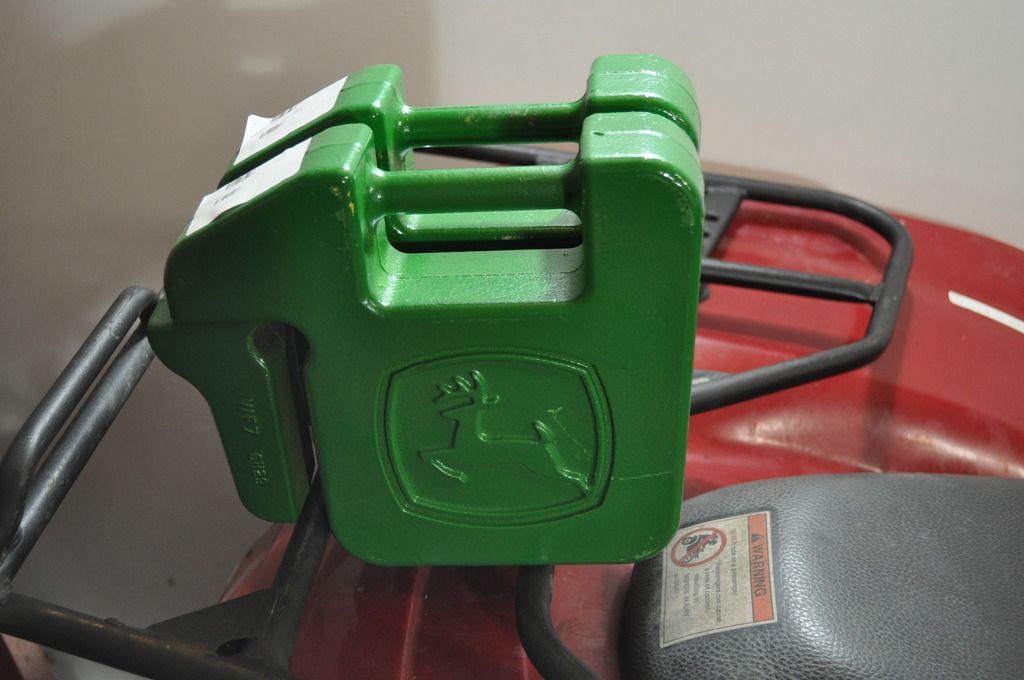

I also have a package incoming from xtreme and heavy hitch so today during lunch i stopped at the local green dealer for some weight.

Hose looks like a big black
snake.

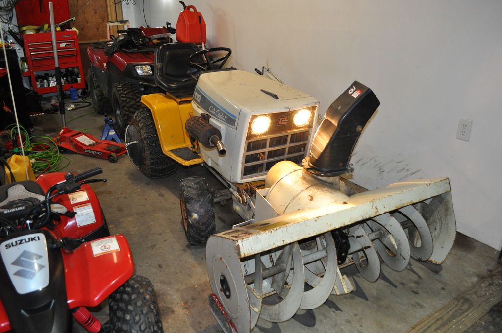

Snow thrower looks good on there.
