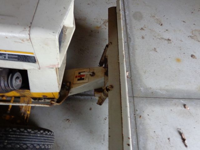

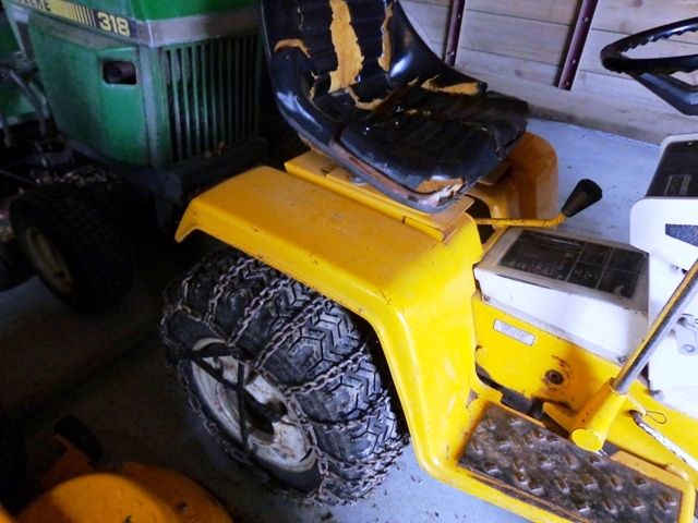

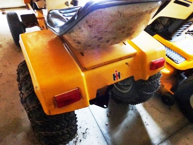

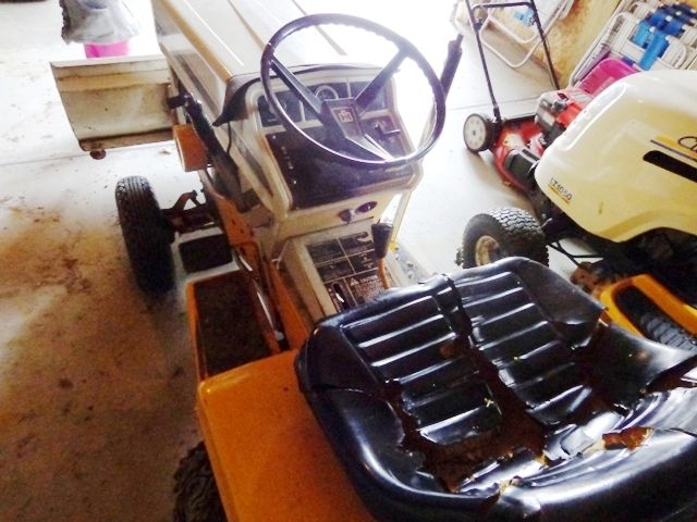

Guys,
Its been to cold for the maple sap to run, so I had to work on something.
The 86 needed attention:
The seat from the 1715 will do for a while.
Started to pull the engine to repair/ service clutch.
Continued in several posts:
Regards,
Chris

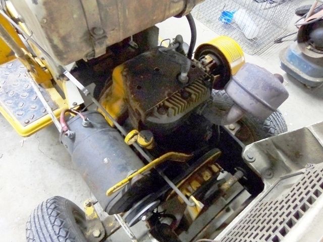

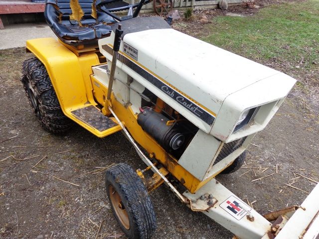

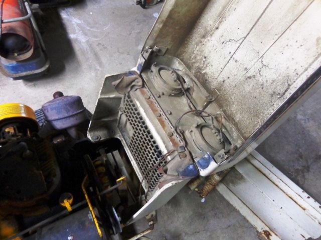

Some shots as the engine attachment came off and the engine is out. Some clean up required.

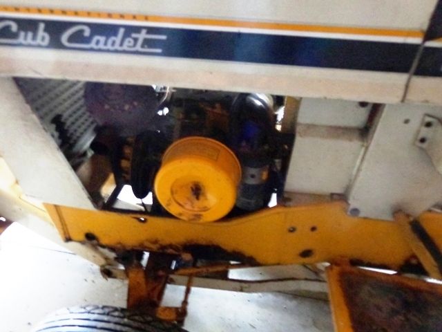

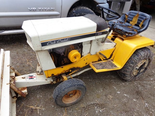

More items removed to get clutch out for inspection.Clutch roll pins were shot on the end by the trans.
Really liked having the tunnel cover on this model compared to a NF.

Clutch sees the light of day. Coupler was pretty loose so the drive shaft was Mig welded and ground to take out the slop.
Stub shaft from Trans had been worn from broken roll pin. Since this is hardened shaft it was not able to be fixed without replacement. A new spiral pin in a new hole through the collar will help keep this tractor moving for a long time.

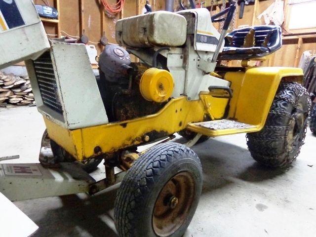

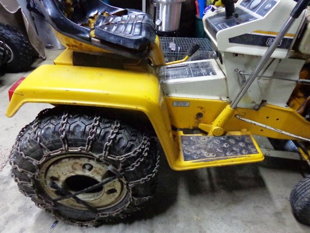

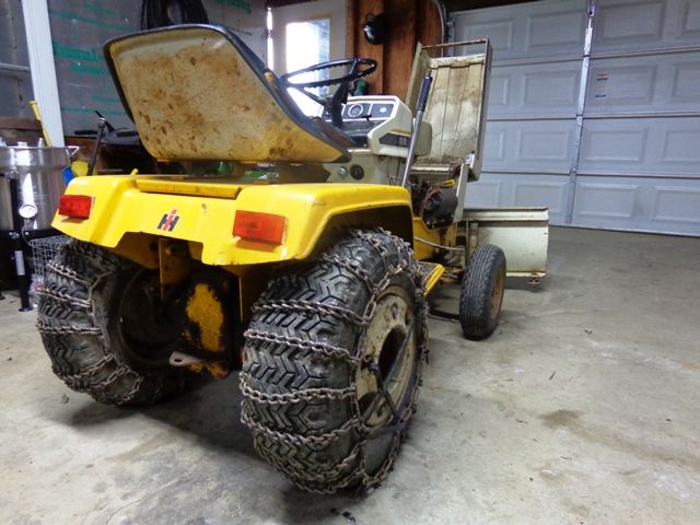

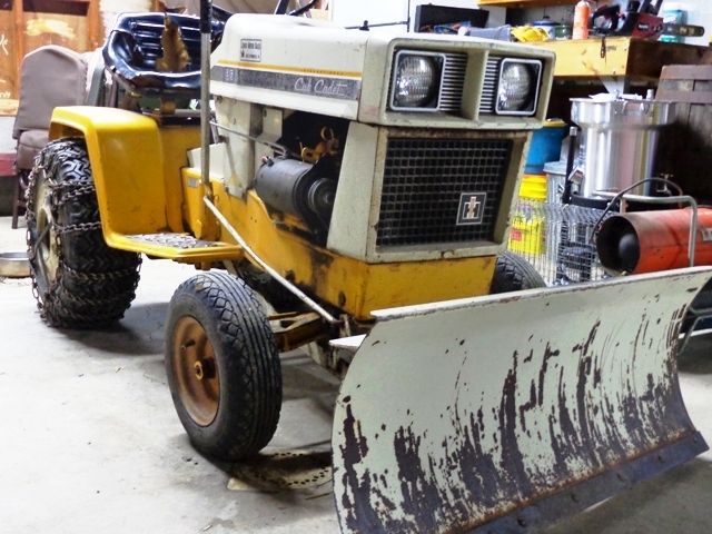

Starting to come together! Engine back in. Clutch and brakes adjusted.
Some shots out side in the snow.
Seems to run good. Clutch tuning was worth it.
Also replaced the bearing for the PTO and reinstalled that. So its ready to mow some grass or plow snow.
Regards,
Chris
