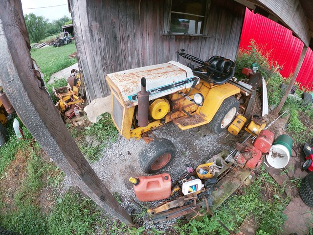

Ok picture time

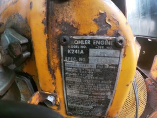

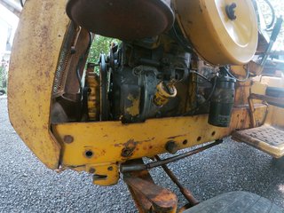

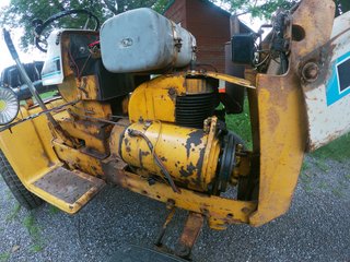

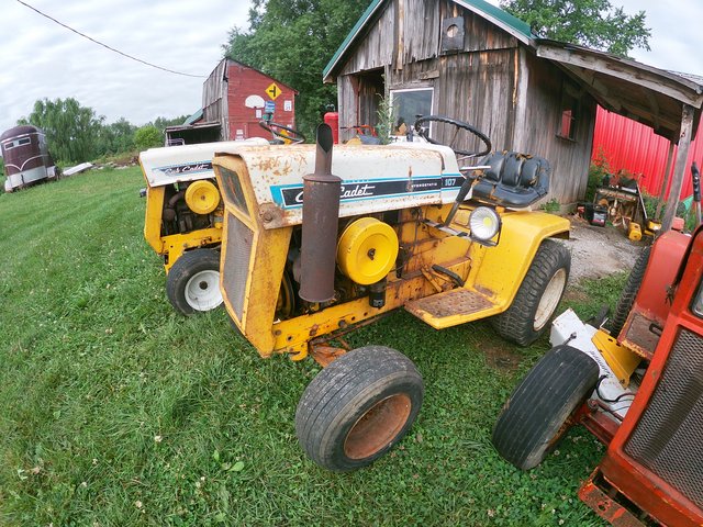

Well, I realized that I never actually got pictures of the engine itself, which is supposed to be the reason this project thread has dragged on for almost 8 pages. So here we go, all the sheet metal is off the k241 so it's difficult to tell, but if you look closely and spot the oil dipstick on the cam gear cover, as well as the deep sump oil pan, you'll know that it's a k301.
I've made a couple small improvements. Fixed the throttle issue, so now it throttles up and down like it should. Also tuned the carb. However, this project isn't quite done yet. There's at least one more thing I've been meaning to do ever since I started this thread months ago. And that is, adding another flex disc to the driveshaft coupling. I have ran it with only a single flex disc, and that single flex disc takes up a decent space where 2 flex discs would function a lot better. So the plan is to pull the driveshaft and add another. This one's on a time crunch though, since I have the looming deadline of the County Fair to complete this so I can take it there to put on display!
