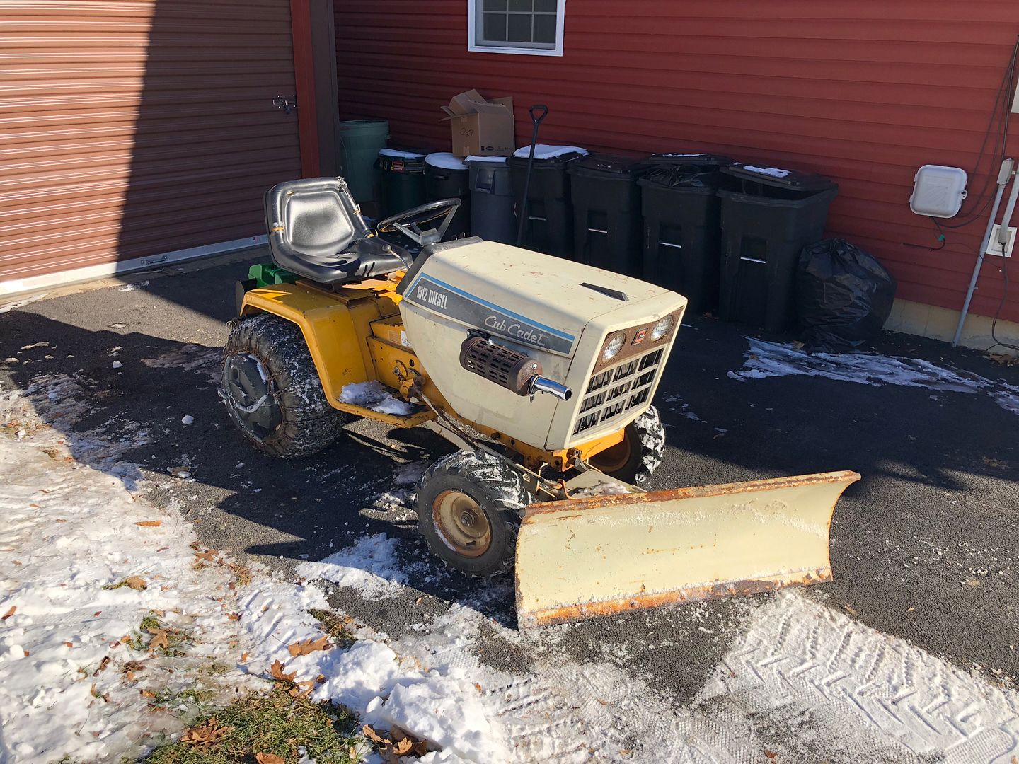

Getting back into the swing of things. I keep burning out ignition switches so i started dinging into it. i found when i did my GR starter my hole was a little small and the starter would ark out while cranking. I pulled my starter today and fixed the whole and ordered a new switch from kubota it will be here tomorrow.
I installed my new muffler and tip and did a good PM service all the filters and fluid in the freezing cold.

Looks like you are ready for the white stuff.

Looking good John, I put a rubber grommet around my hole.
I should have done something like that from the start but now that it's 7 degrees outside i just made the hole larger with my rotozip so i didn't have to pull the plate back off.
I need to order rubber mounts but i'm having sticker shock at 50.00 a piece.
