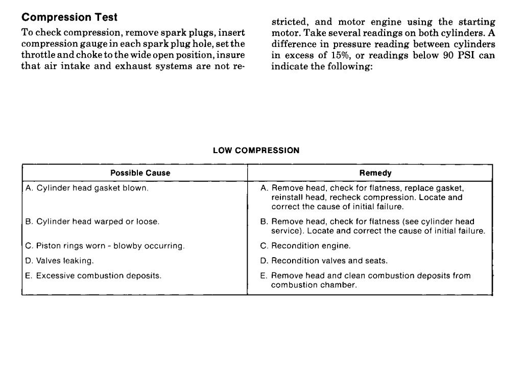

I pulled the engine from my 1711 today, a kt17s to degrease and put new crank seals in. Before I pulled it I did a compression test. Both sides had 96 pounds of compression. The Kohler manual suggests that above 90 is ok. How much compression do these motors have when they are fresh? It runs good and doesn't smoke so I don't think I'm going take apart any farther than to put crank seals and check the valves and new head gaskets. What do you guys think?

I don't recall the manual listing a specific compression, only just as long as they are not below 90.

most any engine be it a chevy, ford, kohler, or any other will have 150 or better fresh. you at 96 are at the bottom end of life she will be a smoker soon
