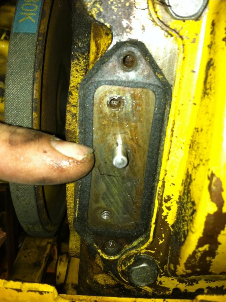

This pin how often does it move? and about how far it come out? This one barley moves and i have to spin the motor by hand a few rotations it seems to get movement. Also should it be easy to turn by hand? Im using my hand turning the s/g pulley with no tools.

That pin is what rides on the lobe of the cam shaft to open and close your points and depending on how wore down it becomes from moving in and out at the speed your engine is running determines the gap of your points. If it does not move freely you need to clean it till it does. Mine is getting wore and I have to set my points at .024 to be timed right. Once you get the rod moving free try static timing you engine. There is directions on this forum for that.

Thanks for that info. The rods does move I had it out. I'm just not sure how much it moves out and in from riding the lobe.
