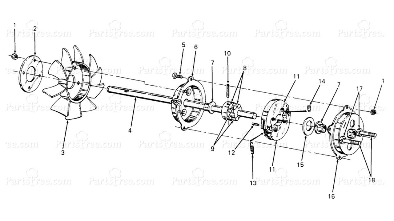

I broke the roll pin in the clutch on my 1572 over the weekend. It's item #10 in the diagram below. It's part # 710-3035 .25" X 2.25" and of coarse it's NLA.
Does anyone have a good lead for a replacement pin. I know It needs to be a coiled roll pin and I think there also hardened. I found some pins at McMaster-Carr in the link below, but I'm not sure if there's something else out there I should instead of these.
http://www.mcmaster.com/#95755a429/=10180nn

The McMaster pin should work just fine. You may need to shorten it. A cut off wheel in a die grinder works well for that task. For what it's worth most people remove those clutch's and just go to a solid drive shaft or up grade to the CV style. I'm sure Oak will be along with more info.
