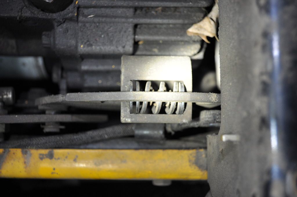

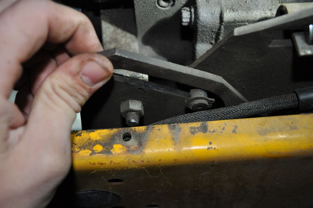

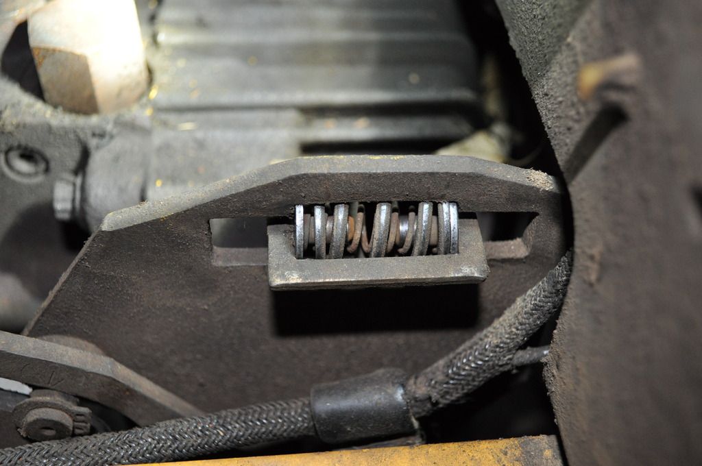

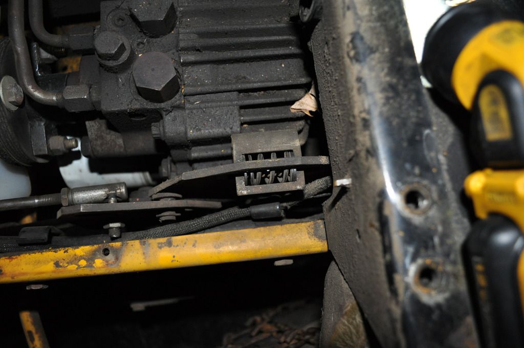

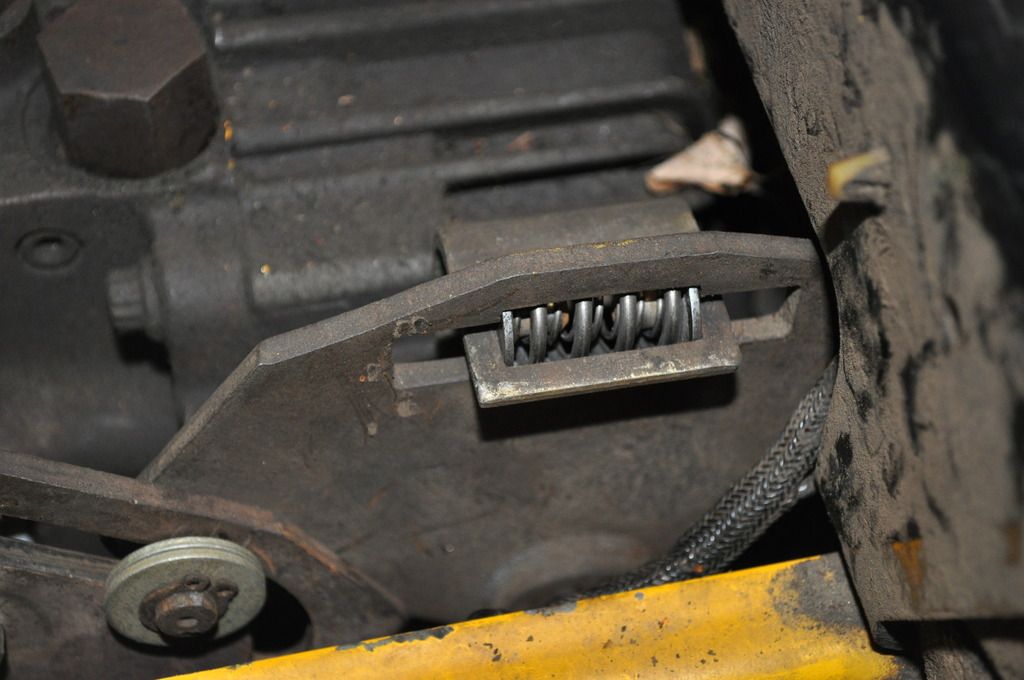

I decided to go out and take the fender off the trunion looks a lot better then i thought but the spring is very loose is this normal? Also the plate the the rod attaches to is very loose and sloppy i am assuming this is also an issue anyone have anyway to tighten this assembly up?
This plate is very loose feeling.
