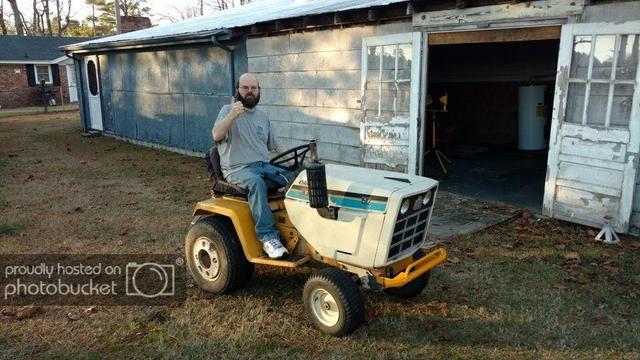

Thanks for the suggestions, guys! Got the 1512 to fire up today. It was warmer at 63 degrees. I still believe the battery maintainer helped! Thanks again, everyone!
