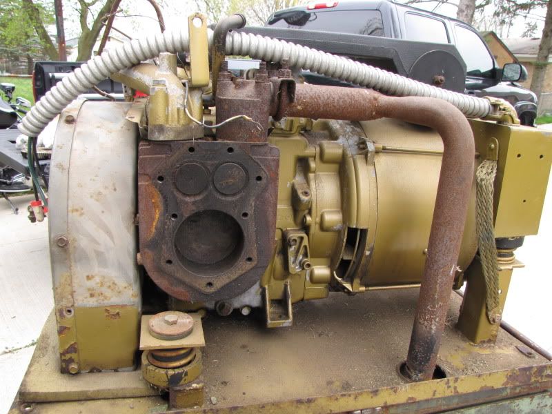

While shopping for a replacement motor for my 782, I found this Kohler generator on CL.I was hoping it was a series II, and be a suitable replacement for my Cub. Does anyone know anything about these generators?

That spec number belongs to a series II KT-17. Series II engines were put in cubs. Actually, they are preferred over series I by most. May want to request some pics of the flywheel end. I'm not sure if all of the flywheels were the same or not. Also not sure of what it would take to put a PTO on there. Nice find, though. Does the generator still work too? I see a custom fab generator if it does.

The flywheel shroud is completely different on that engine, and it also appears the closure plate at the PTO end is different, as well. Generator cranks are tapered, so you won't be able to use a PTO clutch. I'd keep looking if I were you.

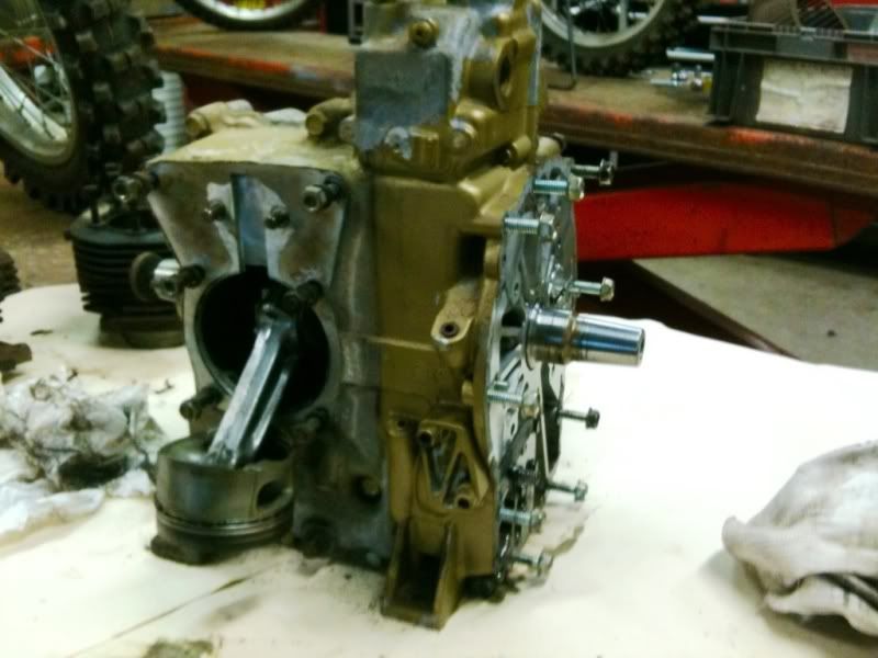

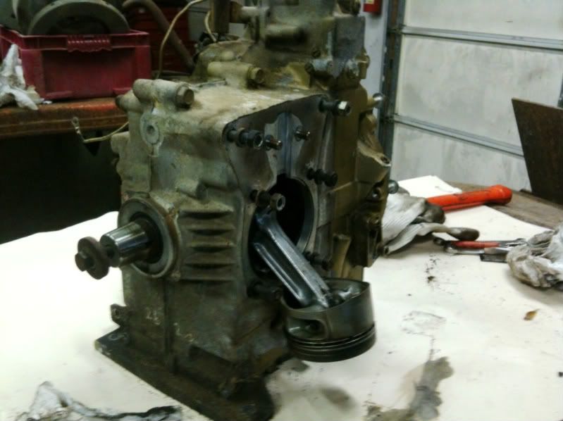

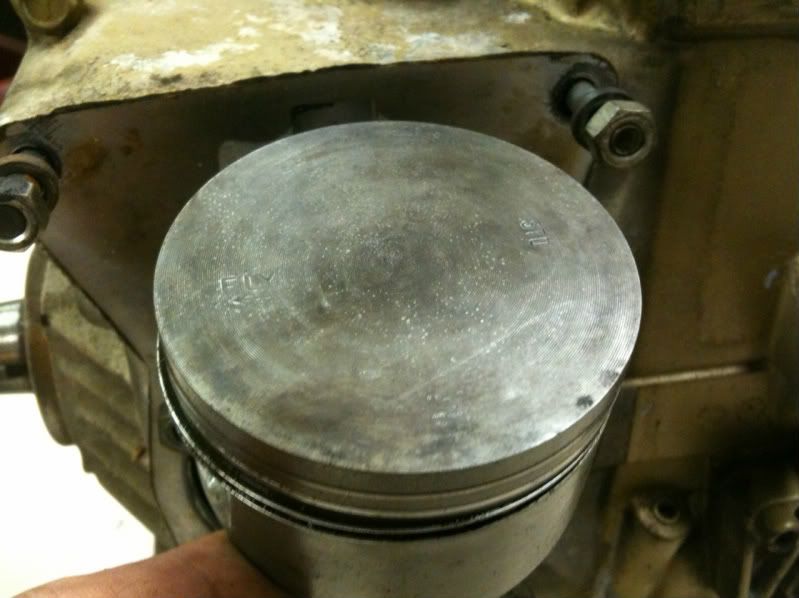

Well, it if the crank and #2 cylinder from the motor in my cub are ok, then I think I can make a complete KT17 series II from all of this?
Upon dis assembly of this unit, it became a couple of things became apparent. The reason it had low compression is because the rings were stuck in the ring grooves on the pistons. That was because water had gotten into the motor. Each cylinder has some rust in it, #2 is pitted beyond honing. But other than that, it had very little wear showing on the piston skirts or cylinder walls.
The cranks is tapered, so I hope my old one is ok.

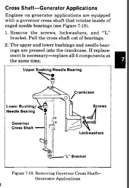

The service manual talks about a generator motor specific govenor assembly? Not sure if this will cause me problems or not.

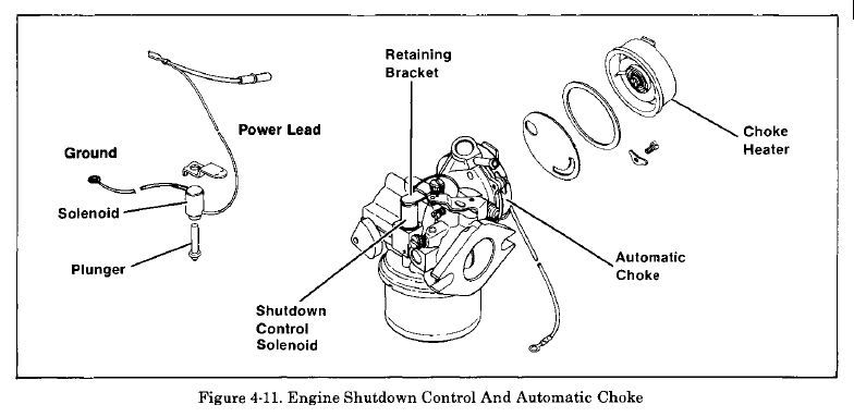

One advantage could be using the carb assembly from the generator motor. It has an electric choke and an auto fuel shut off. My cub on (2) occasions, filled the crankcase with fuel, and hydro locks the motor. Forcing an instant oil change. This auto fuel shut off, may be a benefit.
