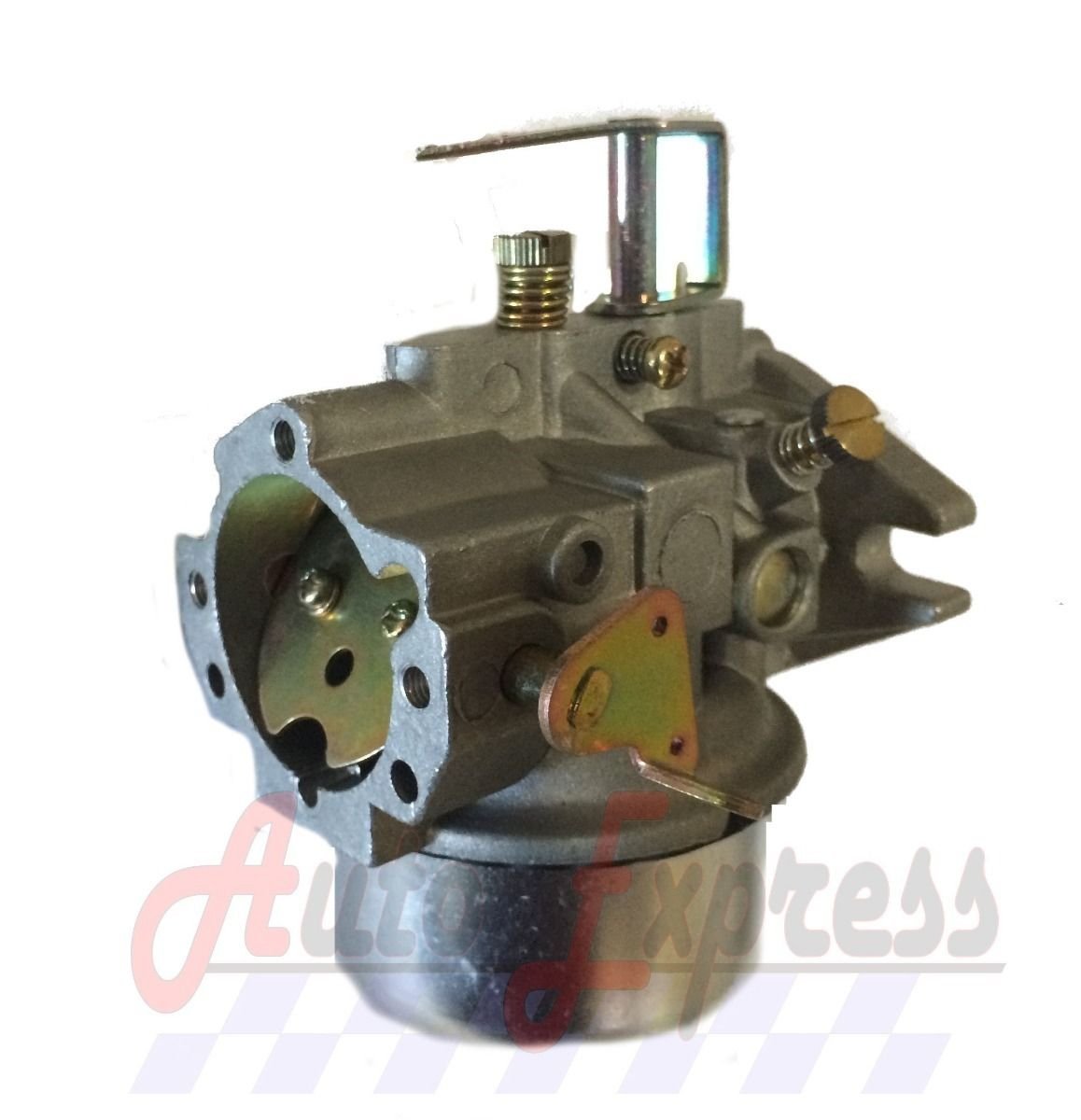

I bought a replacement carb on Amazon for my K-241 in my 100. My old carb was just wore out and I could not see buying a kit, new float, and a throttle shaft and bushing kit. The replacement cost less money and when I installed it I it started right up and idled well. After a warm up I set the mixture screws, idle speed and the WOT adjustment. It has ben running excellent and the engine has never started this easy or ran this smooth. I can recommend this one if your carb is beyond repairing or if you just want a new replacement. I my self will always try to rebuild the original carb if it is feasible but when a replacement is cheaper I will replace it. I agree with others that these are simple carbs but sometimes it makes more sense to buy a replacement. Good luck on what ever way you decide to go. Here is a link to the carb I bought.
https://images-na.ssl-images-amazon....L._SL1200_.jpghttps://www.amazon.com/gp/product/B0...?ie=UTF8&psc=1
