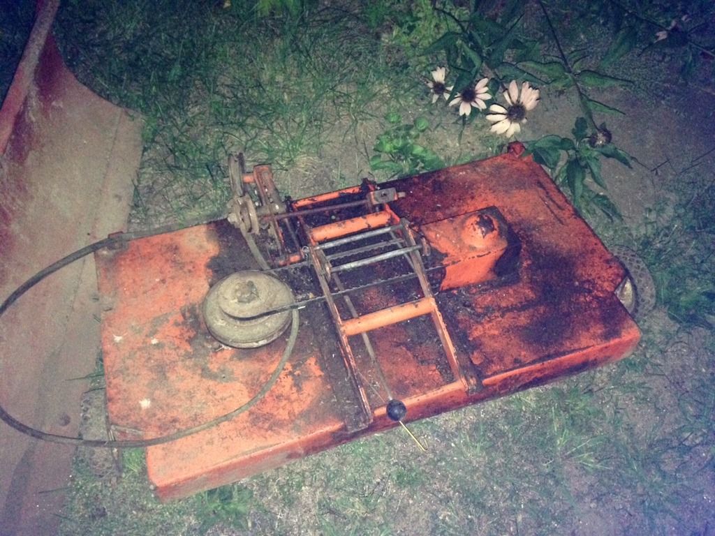

Hey guys my neighbor just gave me this Jacobsen Chief 1000.
I dont know anything about it other than it was made from 64-71.
It has a 10 or 12hp Kohler on it.
It came with a blade and a mower deck. It has a hydraulic lift, appears to be the same on on the NF cubs

Mine was a Minneapolis-Moline town & country 108 but built by Jacobson
with a kohler 8 hp.
It had a timed 36" deck with a sliding arrangement to engage the deck belt. Also came with a Tecumseh engine that nobody liked.
They were a tough little mower that my twin boys could not destroy, and that was saying something, Ha,LOL.
I used it prolly 10 years cutting about 3 acres.
I did have a problem with deck spindle shafts having to make a few, as the timing pulleys would wallow them out in the keyways.
The transaxle takes 90W.
If yours is a 1000 series, thinking they were a 10 Hp.
I never has a hydraulic lift on mine.
Brakes were just a band, around a flat pulley on the side of transaxle, and a notched lever for parking.
check the oil seal there, and the one on the drive pulley shaft.
That has the origional tires on it.
