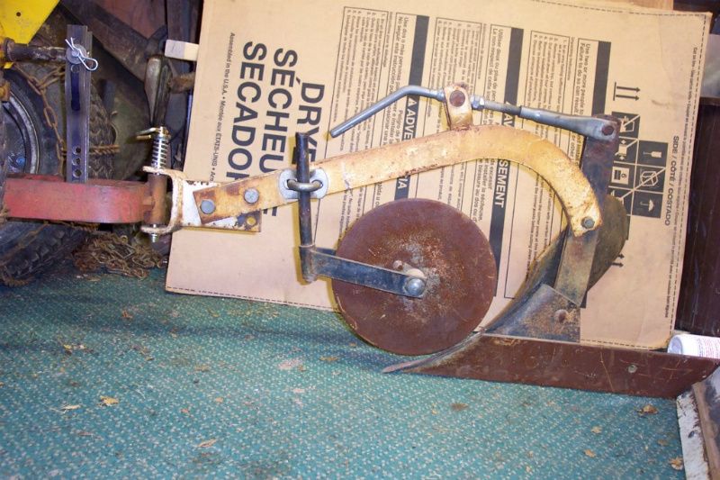

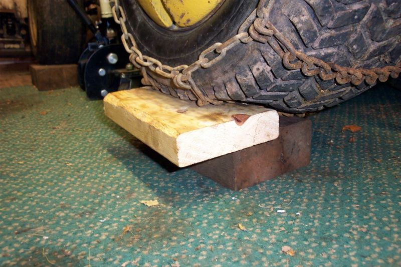

Can't seem to figure out what I'm doing wrong. I see the pictures of people plowing with their cubs, with nice deep furrows, with the right wheel down in the furrow and the tractor leaning over doing a great job. Mine seems to only want to go 2 or 3 inches deep. I was hoping that someone with experience could look at these pictures and let me know what to change. Thanks in advance.

1st get ride of the coulter wheel. Put the left side front and back wheels on 2 2x4's the back furrow piece should lay flat with the ground. Try this 2/
http://www.ihcubcadet.com/IHCCFAQ/PlowSetup.htm
Old 04-01-2012, 07:56 PM
I haven't turned any dirt yet with mine, but was told to have it set like this.
Sitting on blocks on the left side front & back
With the plow sitting flat or slightly nose down
Do you have the Brinly plow manual?

Is the clevis bolted in up side down with the agle the wrong way? I am just THROWING this out...I'd have to stand in front of mine to see if this is even physically possilbe to bolt it in upside down???

also the first furrow wont be as deep as the 2nd pass will be.

Loose the spring and hitch pin on the pin for the plow. The stuble in the field will pull out the hitch pin and the spring will pull out the pin. Also the sleeve hitch is upside down.
plowing rookie mounting the sleeve hitch upside down for pictures
So just the hitch pin stuck in the hole with no hair pin? ( just want to make sure )
Thanks

You can lose the coulter or add some weight to the plow. Do the plow setup thats on this sight. If you don't have weight on the back of the plow, the coulter will not let the plow pull in. After looking at your first pic you need to adjust the point of the plow up and move your coulter about 1 inch from the plow. Hope this helps
