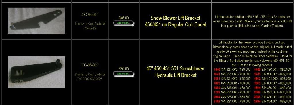

here is a picture. I'm guessing it is supposed to be a pin in the bottom hole
Old 12-09-2011, 07:09 PM
These are available at xtrememotorworks.com

I have the bottom bracket with no place to bolt it. My very early 2182 has the bracket welded in place from the factory. I still think the pin is broken off. I will just use a hardened bolt with 2 nuts and some washers.
