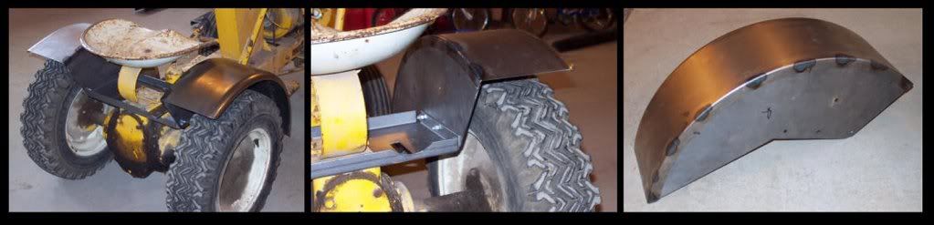

These are what "O" fenders will look like. A pan fits across the frame to attach both fenders then an all thread rod fits thru both fenders and under the seat spring to add some stability.
Picture courtesy of xtrememotorworks.com
The fenders for the other Narrow frames use angled brackets to attach the fenders to the frame at the seat and also have axle tube brackets that wrap around the tube for extra stability.
You could make one or the other work for each style but it would take a little metal work and time.
