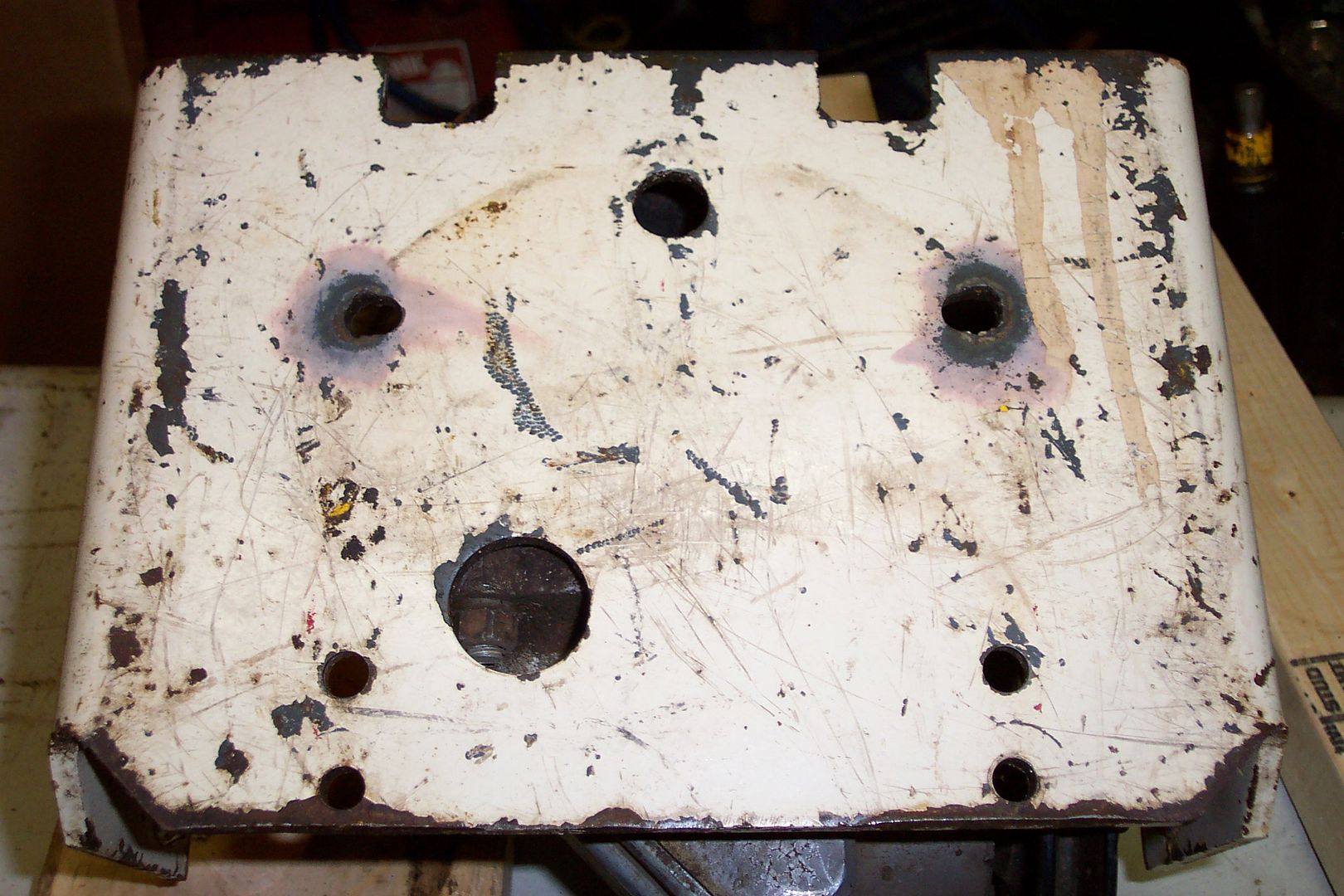

Old 02-11-2012, 07:16 PM
Originally Posted by amccune View Post
........So, by the mount, you mean the part that hooks directly to the sleeve hitch? As in, the mount on the gear box? Didn't realize it could come without it.
The mount is what the gearbox is bolted to. It is secured with five bolts thru the rear cover into the rear end. ( use longer ones that the ones you take out )
click for bigger
This is the back of the mount ( upside down ). Notice the five holes in a "U" pattern. That secures the mount to the tractor.
