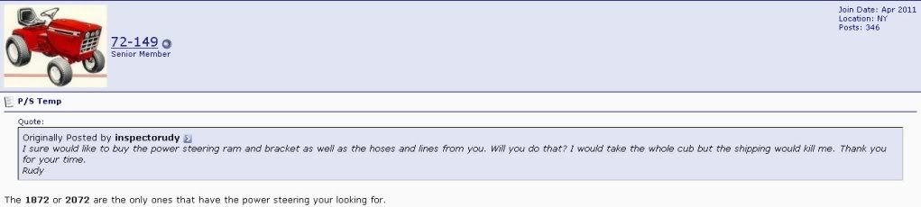

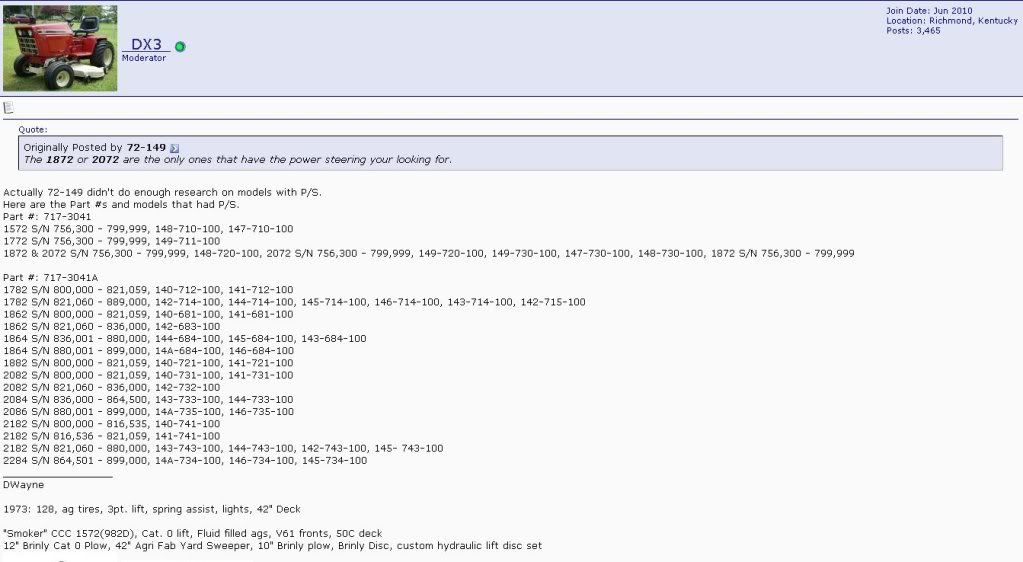

I thought I would start a thread here for people who have power steering on their cubs to show pics of their cub and what the ram and mount look like. There is always some questions about this from people wanting to add P/S to their non Powered GT and this could be of some great benefit for them and a learning thread for others such as myself. I'll add from another thread some posts that might get this started. Please add input and pictures as you see fit.
