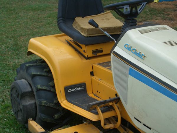

inboardnut, you are right, those shift handles are to short. Here is the one PaulS is refering to that we went with.
#10-149 with a 38inch deck.

Ok in that pic does anyone notice another modification which is clearly visible in the pic. Eric and I used a piece of threaded rod and a connecter and just bolted it on no modification to originality was needed. It was cheap too, less than $2.00.
The custom upholstery job?

Nope that is just so my bottom feels good when speed mowing. There is something else.

[QUOTE=PaulS;157858]Ok in that pic does anyone notice another modification which is clearly visible in the pic.QUOTE]
Ag's? Wheel weights? Spiffy new-lookin floor board covers?

Yep Pokey hit it. Those are not new spiffy foot rests but I did clean them and then Painted the "Cub Cadet" in yellow. It may not last but I thought it makes it stand out.
WooHoo! It's like winning the lottery!

Yes it is, you are the winner of one dried up artist paint brush that I forgot to clean.
