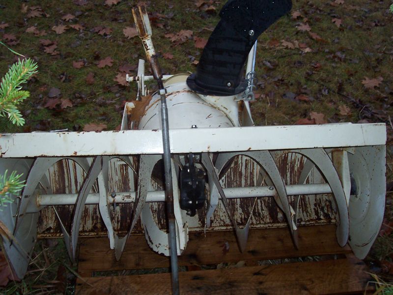

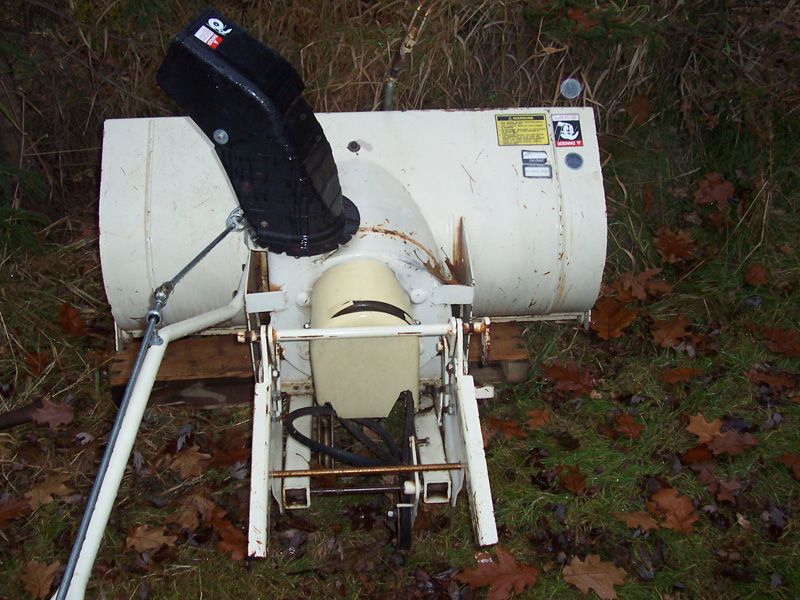

Thanks for the info. There happens to be a guy right in my town with one he wants to sell (I posted a wanted ad on craigslist yesterday). It seems like he's asking a reasonable price for it. It sounds like there are a couple things it needs- A tensioner spring for one of the pulleys (not a big deal), and he said it looks like the lifting rod was extended. If you look closely at these pictures, it looks like he's right. Is there any reason someone would do that??
Are there certain things I should look for when I go to look at this blower?

I paid $650.00 for my 451, and had to drive across 2 states to get it. Looks like the lifting rod is bent compared to mine. Maybe for a differant model? Spring you mention is about $6.00. Great blowers once the are set up right. Don

So, I picked up the 450 that I found locally last night(the one in the pics). It looks pretty nice. It bolted right up nice and easy. The only problem right now is that lifter rod that is bent and extended. It's not even close to lining up correctly. I might fix that one, or just buy a new one for $50.
Anyways, I see there's a model 449 lift assist spring kit. Is that required for a manual lift machine? If it's not required, is it highly recommened? As part of the kit, I see some stuff that attaches down under the machine, that I'm not sure the purpose of. The main thing it looks like is a big spring that attaches on the left side of the blower, back to the side of the tractor. Could I just fab up a spring holder here and attach a large spring myself since that kit and spring are no longer available? Does anyone have any specs on what size spring should be used??

Just looking at your blower it appears to be identical to my 451. My 451 comes with a bend in the lift rod to clear the front axle. I have hydraulic lift for mine so yours may be for the hydraulic lift. After dragging mine around a bit if you are using manual lift you will definitely need spring assist. That puppy is very heavy. Without spring assist your right arm will be of weightlifter quality by the end of the winter.
