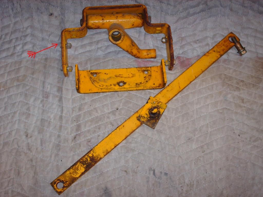

Looking more closely. I am not sure what 147 Hybrid I just picked up? It really looks like wide frame 3pt mounting is what this is set up for. I will have to post some pic after the Christmas Season on what I got going.

That parts lookup thingy got it all wrong.
You will need this bracket that goes between the frame.
And this stuff here plus the bracket.
This is what the bracket looks like installed.

That's a rare part too.
Not sure how CC screwed up that pic but not my fault this time!
Old 12-23-2012, 08:30 AM
Yup, Lew nailed it. I knew the parts lookup was wrong, but didn't have the pics to explain it.
