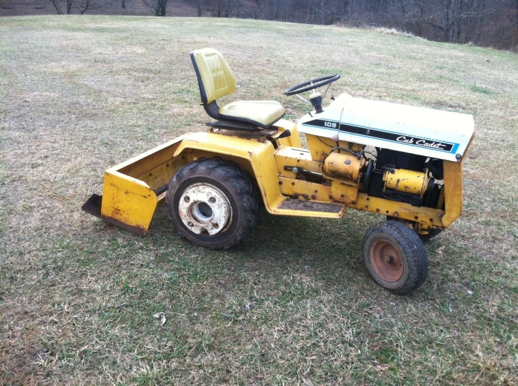

my homemade box blade only weighs about 50 lb and it digs into hard packed gravel pretty good when i add one cement block to it. i think its more the angle and design than the weight that makes them work. i can adjust the angle of min depending how much bite i want. looks kinda silly but works great.
Macman, do you have any closer pictures of the box blade? I'm going to either need to find or build one this spring; I've seen the cheap brinly 38" one at casa depot for $190, but I question the build quality of a lot of newer stuff (if anyone has that and it's decent, let me know). I saw that reproduction thread for the #40 back blade and that is nice, but I don't think I have nearly the resources to pull something that nice off.
